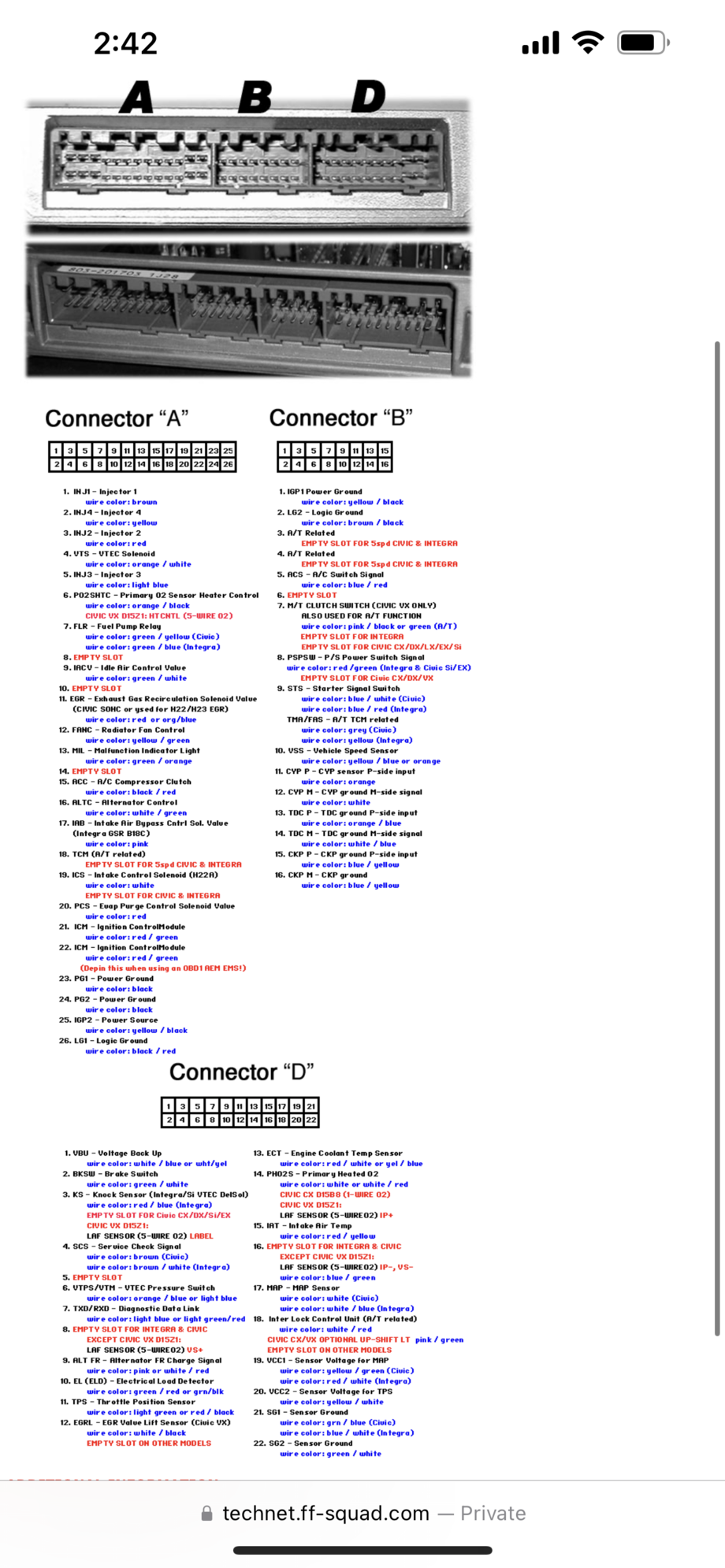

also this is the pin out I’m following

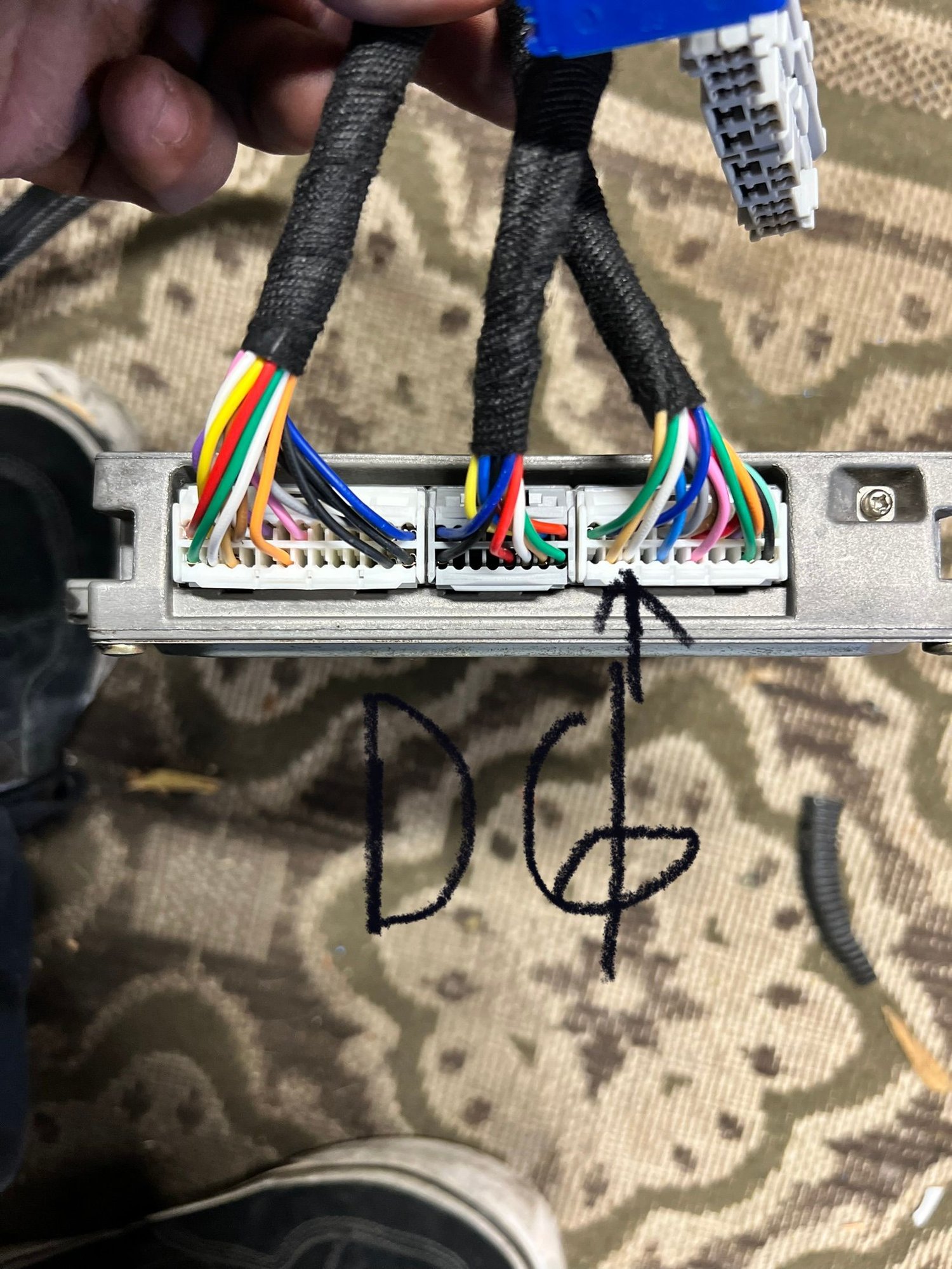

and then this is the ecu with the cable in it

If you wanted to run the VTEC pressure switch (I'd recommend this, and it's mandatory if you have a stock ECU and want VTEC to work), then you could simply get a plug kit and solder it together yourself. Since the wire is already pinned into the harness, you'd just need to find the other end and connect together what's needed.
https://www.ebay.com/itm/15310226408...3ABFBMvJjJ659h
Without seeing exactly what you have in front of you I can't say exactly, but that's the route I'd go. Best of luck with the Amazon harness, hopefully it all plugs in correctly and works reliably.

So you don't have the clip for the VTEC pressure switch, and you also can't find the other end of the D6 wire? If you don't see it coming out of the other end of the harness, it raises the question on if it'd even be worth trying to find it, since if it's cut too short you'd have to extend it to reach the VTEC solenoid anyway.
At this point I'd message the seller on Amazon and see what they say, hopefully something useful.
