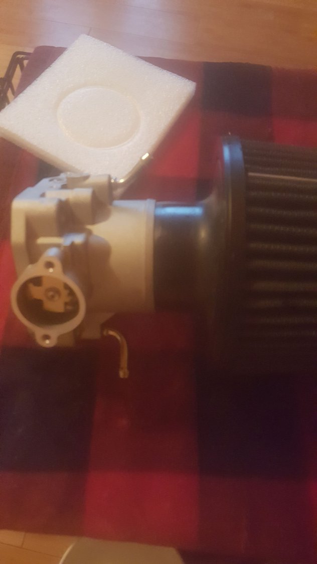

Im new too the whole car scene, so I just learned that people can put individual throttle bodies on engines, seemed interesting. What I wanna know is if anyone has just ran one throttle body with just the Airfilter to get rid of the intake hose/line/tube to clean up the engine bay alittle bit. Something like this pic i took.

It has been done... the filter being directly mounted on the throttle body inlet causes significant turbulence and reduces air flow into the engine. To minimize this issue, a tube of at least 8" long between the T/B and the filter is necessary.
So you now get to decide: Pretty or Power ???

How much power could you lose?

On Dyno, I have seen as much as 10hp lost on a "B" series VTEC engine.
