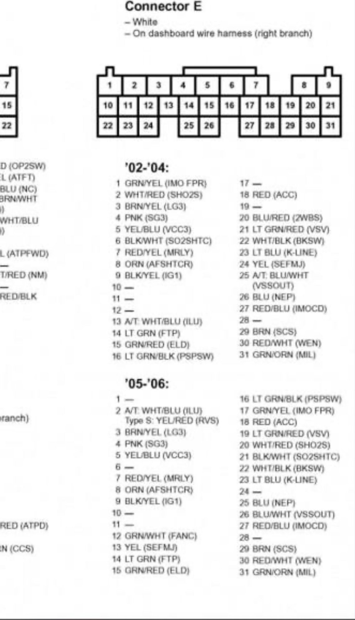

Congratulations. Can you post the ECU pin locations that you used (and what wire you connected to each) so others can follow how you made this work in the future ?

of course. I just swapped the around the 02-04 with the 05-06 pin locations. So swap pin 1 to pin 17 for fuel pump and pin 24 to 13 for multiplex
and I also as for the fpr it’s a cheap on so Ryan was right it’s crappy and doesn’t adjust but it’s working so I’ll leave it for now.
