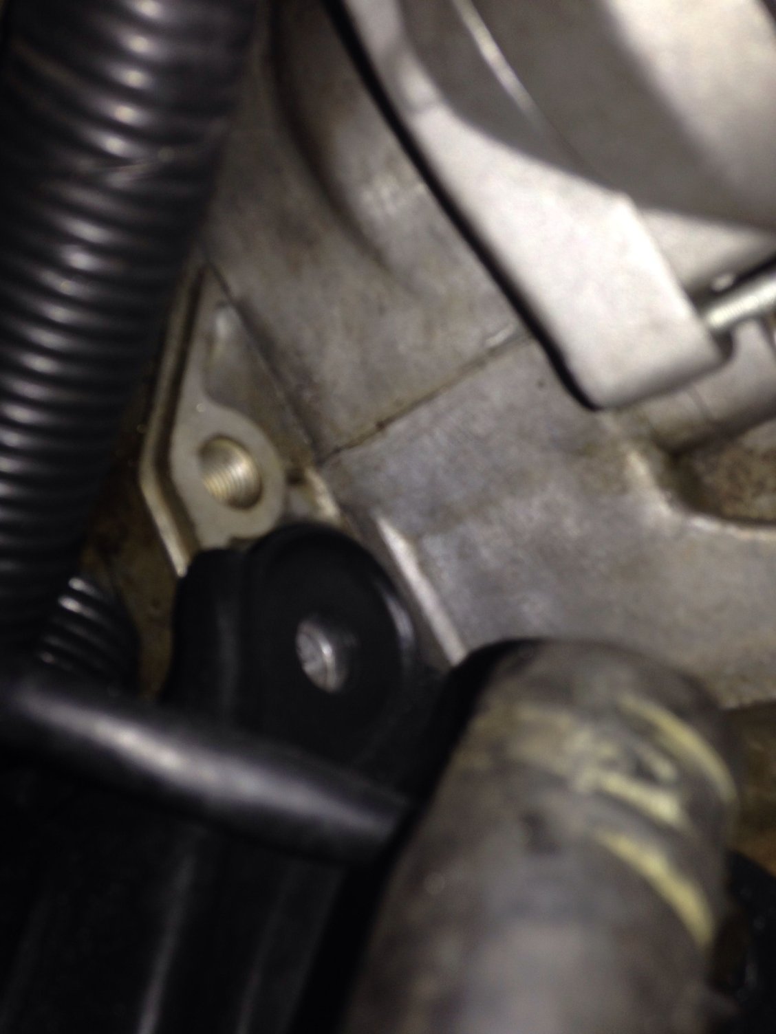

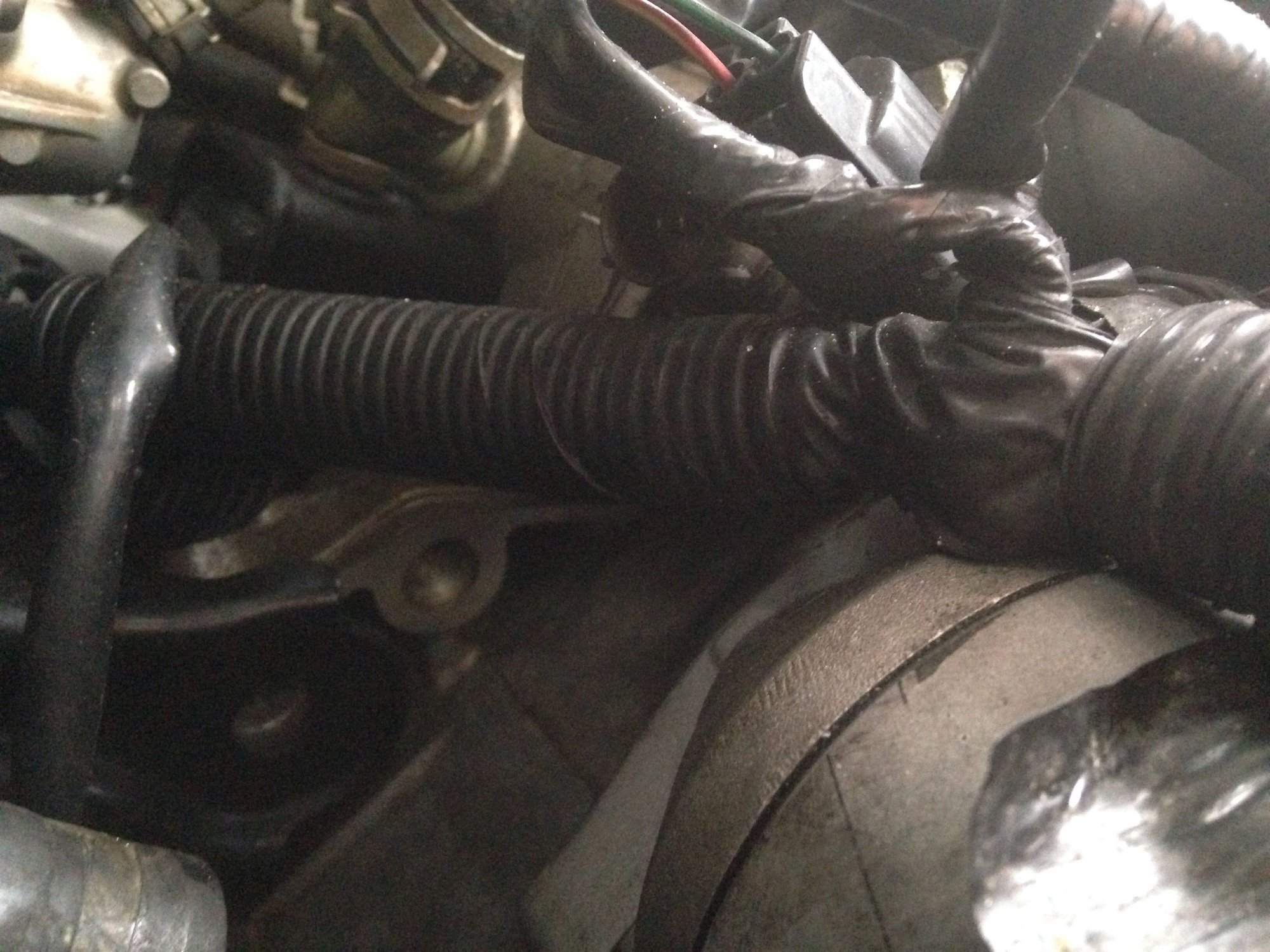

Hey H-T, I can feel my motor jerk everytime I let off and get on my gas & I found that a bolt was missing from my T Bracket, I've also noticed the motor moved a bit so the bolt won't just slide through, I was wondering if you guys would help me and explain how I should tackle this job?

gotta jack up either the motor via the oil pan or the tranny .. put a wooden block in between so you dont damage/dent the pan/motor
