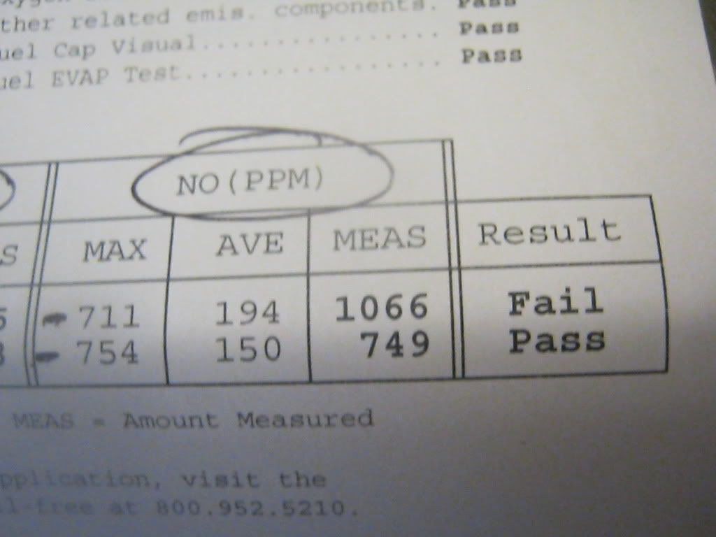

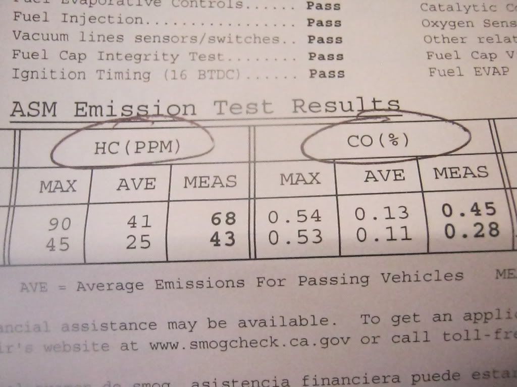

Did a smog check yesterday just to see if would pass, since my registration is up, well i was very surprised that it nearly passed, the guy looked at my swap and just started to work on it not even looking at my engine stamp, well i had the head rebuilt about 2 months ago new iacv new fitv, new o2, original cat, 87 octane, 3500 miles since last oil change any techs out there with any advice, i know its running lean should i retard the timing to 14 degrees bdtc, and put in a step down colder spark plug, i have a new thermostat laying around i might as well change that out too, would that do the trick? my results below:

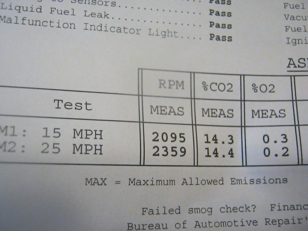

actually you are running perfect. Your a/f ratio using the lambda calculator is 14.7. That is perfect. Your cat is done. That is why you still have oxygen left over and have more hc and co than you should. The cat uses the oxygen to create co2 with the co. But on this sheet it shows that the cat cant store the oxygen.
Bottom line, you need a cat. Your car is running perfect, not lean or rich. perfect
Honda only uses two methods of reducing nox on 5speeds, valve overlap and cat. Your abnormal high nox is another output of a bad cat.

yeah that cross my mind too, but i haven't changed the oil since i put the engine in, and the smog guy said my hc are almost at the max possibly because of broken down oil.

the reality is the cat is bad. The cat is responsible for lowering nox. Yours is doing nothing. I just gave you free diag over the internet. Dont waste your time paying for another smog check and failing when you now know the problem.

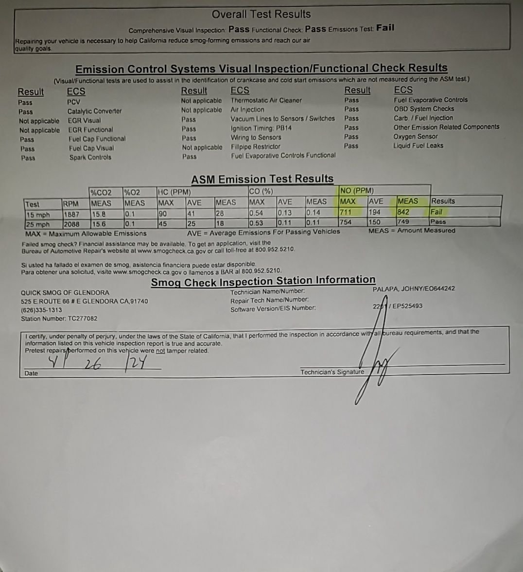

94 integra jdm b20b swap ls stock components new cat new 02 new map new plugs new dizzy new clamps all around timing at 15 all stock failing due to high nox. Info appreciated.
original read spec.

Have you checked your distributor position and verified that your ignition timing is correct ?

yup 15 btdc went over it like 3 times just to make sure

It should be 16' BTDC and you have to check it while the timing is frozen static... you do this by shorting the service connector while the engine is idling.
original read spec.
CO2 looks fantastic.
Your cat isnt working.
Need a new cat. You need one that matches the engine displacement.

I didn't do this as i didn't put the engine in my guy that put the swap in triple checked it. He set it at 15 because it was running high nox setting back the timing was one of the recommendations while staying in spec.
