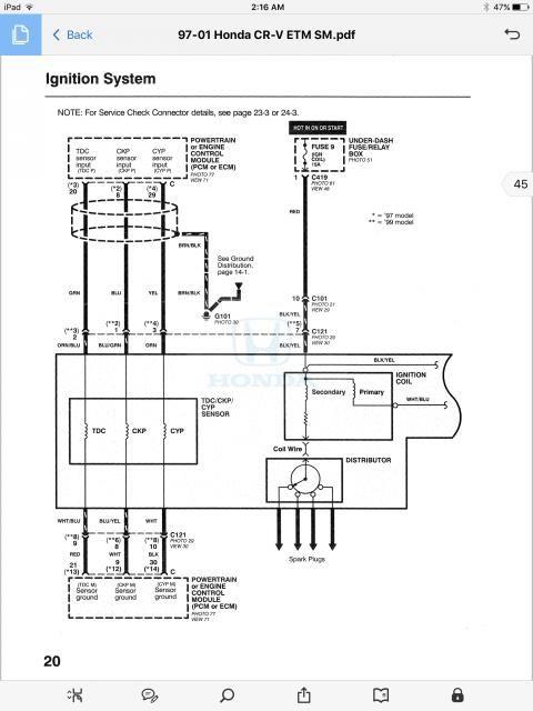

Old Sep 17, 2021 | 07:19 PM
Ryanthegreat1's Avatar
Posts: 3,589
Likes: 505
Default Re: 91 civic bswap issues
Old Sep 17, 2021 | 07:20 PM
Posts: 3,589
Likes: 505
Found a quick pic on the internet. Looks like the shield gets grounded to G101, I believe that is the thermostat housing ground.

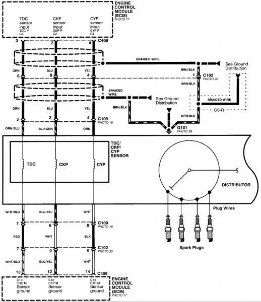

Old Sep 17, 2021 | 07:25 PM
Posts: 3,589
Likes: 505

So if I swap the ecu pins to the shielded wire put those to the clips at dizzy and ground the shielding to the thermostat housing it should be golden?
Old Sep 17, 2021 | 07:43 PM
Thatsmyciv's Avatar
Joined: Feb 2020
Posts: 52
Also I cut the shielded wire from an old all stock harness pulled from a previous scrap car and the shield was soldered to a wire that was ran to ground will that be alright here?
Old Sep 18, 2021 | 06:46 AM
Posts: 3,589
Likes: 505
Perfect on the salvaged harness idea. That was probably a CKP harness.
