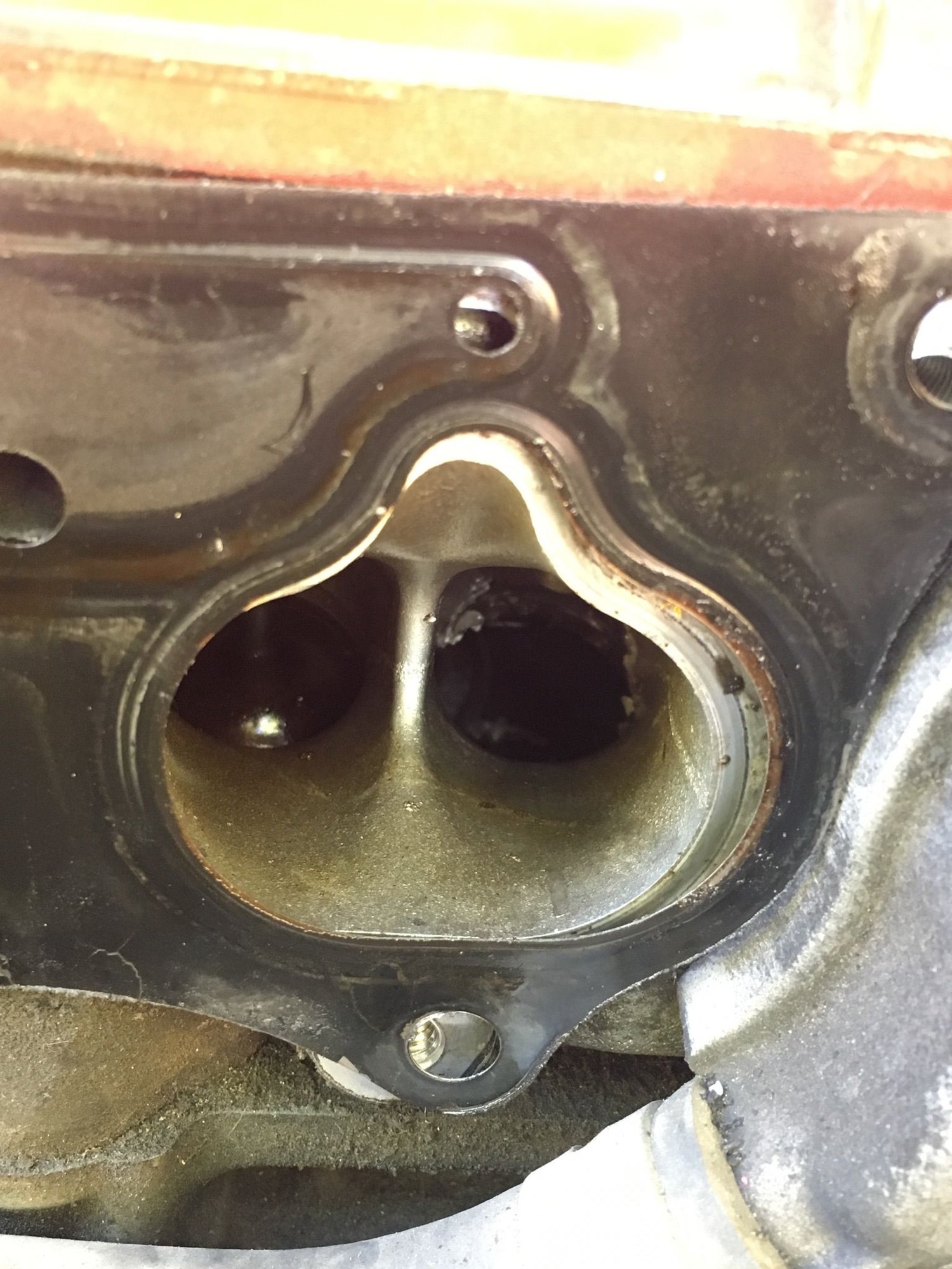

Ok so i took out the manifold and notice what might be the valve spring that look all beat up...what do you guys thhink ??/ could anything in the internal be bad ??

would it be better if i just get another head instead ?

Did you overrev it ? Seems like you can just replace the valve spring, but it depends on the extent of the damage if pieces broke off and ruined the engine.
So today I had a word with my brother who was driving the car that time and he said he was messing with the car on the freeway...miss shift 4th to 2nd. That when everything happen

Pull the head and check. 94
