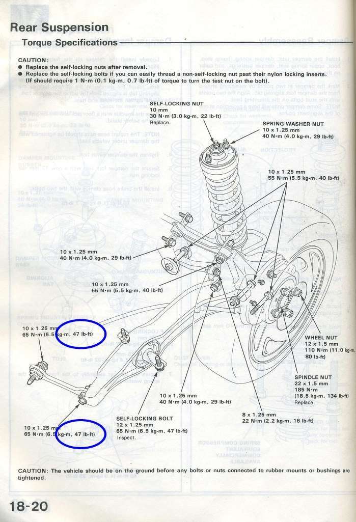

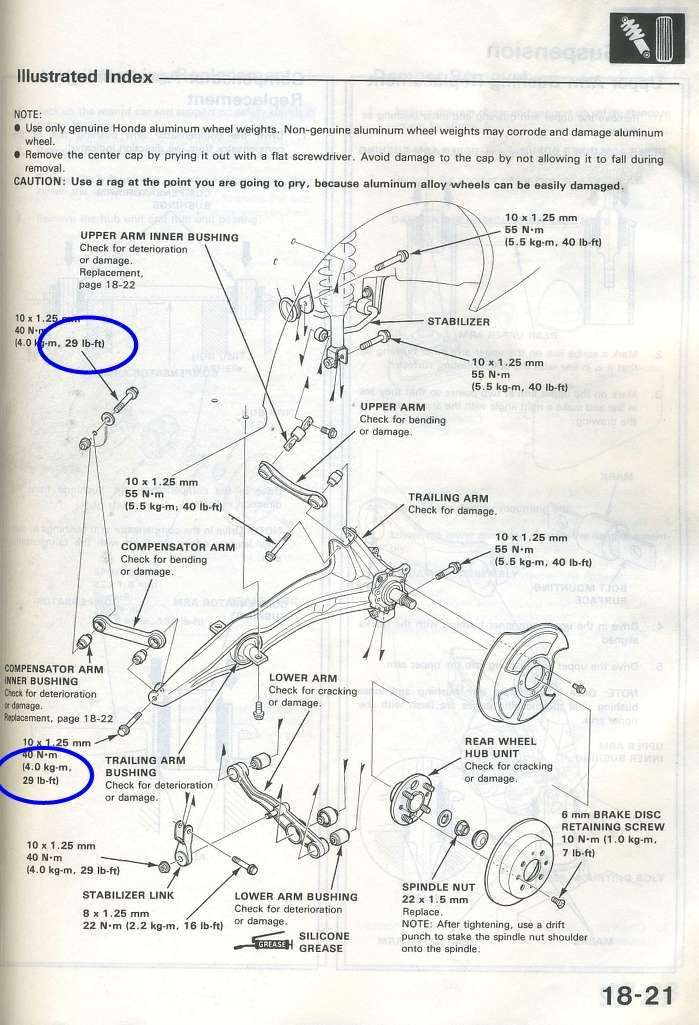

This is nuts, on the 1st pages is shows 47 ft.Lbs.
On the 2nd page it shows 29 ft.Lbs.
Which is correct?
..the very next page in my original '90 Service Manual.
How do they expect anybody to get anything done this way?

Default Re: 2 pages, 2 torques specs
I think 47 is what the dc tegs call for id use that. put copious amount of grease or antiseize on those bolts the tend to seize bad in the bushings
Yeah, I went to 47, but I didn't think of the anti-seize.
You can't get to the one on the end of the trailing arm, so I'd have to take the whole thing off again.
Any other way of getting anti-seize or grease in there?
I 'spose it's needed in all the body mount bolts....
