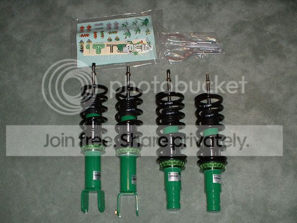

A few friends and I have Tein SS coilovers on our cars (Integras and Civics)... We've noticed some differences between the shocks though... For example, my friend has an Integra and his look like this

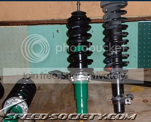

and I also own an Integra, but mine look like this
See the difference? Mine have Green collars, and his have silver... Also, my Tein stickers are on the bottom part of the shock below the spring, and his are on the top part behind the spring...
Just wondering why they look different... is one the old model and one the new model?
From our personal experiance, it also seems as though the silver collared ones will lower the car more (For example, if the front is turned all the way down) vs. the oens with the green collar. My friend has his silver collared ones turned all the way down in the front, with blades and 195-50-15 tires, and mine are also turned down all the way in the front with blades and 205-50-15 tires... His car is retardedly low, with front tires tucking like crazy, and mine just meet the tire perfectly or maybe even a tiny gap.
Originally I thought this was because I have a Skunk 2 front camber kit on my car and he has no camber kit... we thought this for over a year until my friend ordered some tein basics and he has the green collar and his civic doesnt dump that low either (its a perfect drop, woudlnt want it any lower but still) ... and Im pretty sure my brothers tein basics have the silver collar...
Anyway, a lot of reading I know, but can anyone enlighten me on this?

your friends is the old version, yours is the new version. your may also be the japanese version.
i sold my tein ss years ago, due to the "popcorn" effect. and for the simply fact you can not lower teins all that low unless you get the flex system. which i did later which took care of the popcorn effect, and now i run BC RS with a better spring rate.
i personally dont think you will be too happy with the tein ss setup. but good luck
