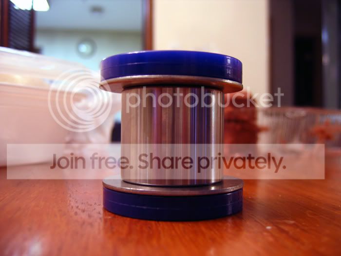

I originally accidently put this in tech forum.
These are on a DC2 / R front lower control arm.

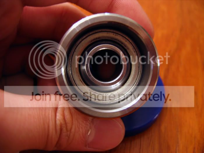

Close up of Bearing in bushing.

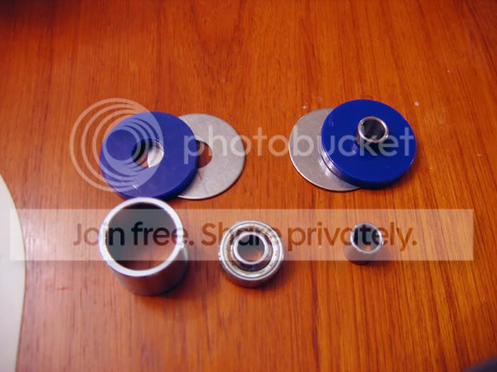

Each bushing holds 2 bearings, one on either side. this will make it a true spherical bearing suspension and minimize and or rid off any twist in the control arm. At the same time the steel bushings will eliminate caster changes for the outside corner wheel.
Opinions are expected, bad or good.
Keep in mind this is the prototype.

what are you thinking using TWO bearings on each side of the opening? so thats 2 spherical bearings in the same place only 1 bushing existed right?
thats totally redundant! it constrains any free movement to ONLY 1 axis of rotation, totally negates the use of sphericals. you might as well make one solid bushing.
you can only use one spherical bearing to allow the spherical bearing to do its job.

I agree, and understand what you mean. I use the Spherical cause I had a few of them.
Next version I am looking into the standard bearings as well as different OD speherical bearings, but the cost for the spherical bearings, well at least from the new supplier does not hurt the wallet.
As I said I started with the design of one bearing but with several bearing in hand I went with double spherical bearings for the prototype.
This is mostly to have something where the chasis only makes contact to the bearing and not a metal shaft and washers which will restrict the free movement fo the arm as some other available kits do.

i would put the spherical in the middle of the hole, and design a conical spacer on each side to give the proper overall width and prevent any lateral movement. you lock the bearing in the middle by using a c clip, so you machine an inside groove in the sleeve.
that would be the basic way of designing this, which is what progress does. adding some kind of outer protection from dirt and oil containment would be the only improvement over progress' design i can think of.

you dont see how you completely eliminated all but one freedom of rotation by using two spherical bearings? lateral movement aside.
good
bad, redundant
yes, you want the freedom of movement. if you didnt, why are you even using spherical bearings?
this is effectively what youve done using 2 spherical bearings.

I see what you mean, my question is, do you want the control arm to rotate on it center axis or just have ability to move up and down.
which is what the constraint drawing shows.
I undestand that 2 spherical bearing kill the purpose of using a spherical bearing, to save time and research for bearing taht would hold up to the weight and forces from the suspension I decided to use the spherical bearings I already had for the prototype.
I agree that standard bearing would be better. So we can understand what I am trying to say make believe the spherical bearings are standard bearings. Cool?
Here is the reason why I put 2 bearingsin the bushings
http://www.imagestation.com/pi...a.jpg
Looking at the control down the lenght of the arm, a single spherical bearing would allow for the fork and control arm to rotate on its center axis (a long the lenght) in a turn it would cause the arm or fork to rotate changing the caster.
I hope it makes sense. This is what I am asking that does the caster need to change in the turn?
or would a static caster be better?
If you set the caster to 1 degree, Is is better for the caster to stay at 1 degree through the turn or is it better for it to change as the weight of the car is on that corner?
Does this make sense. this is why face to face conversions are better.....
