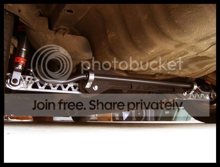

I just hope that there won't be any difficulties installing an ASR combo with these LCA's.
I don't know if you're supposed to feel a significant difference with LCA's installed, but I really don't feel any difference in ride quality.

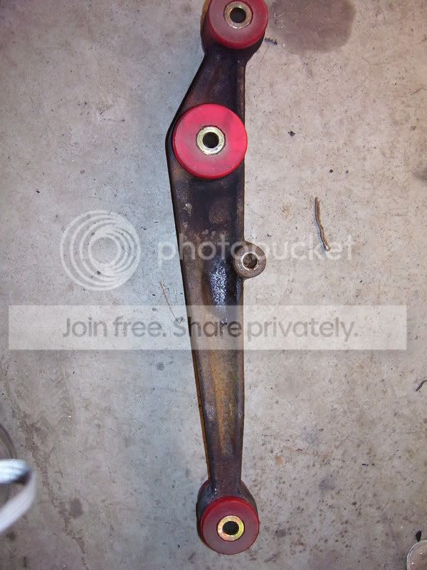

No you can physically see it. An OEM bushing (most companies use the same design) is a metal sleeve surrounded by rubber, which it then surrounded by another metal sleeve. Typically these aftermarket arms will have issues with the rubber separating from the outer sleeve.....allowing all kinds of unwanted suspension movement.
More often than not, the bushing failure goes unnoticed....you need to either check them very closely, or disassemble to inspect......just jacking it up doesn't always catch it.

That's fine, but installing a set of control arms and then having to re-bush them every 6 months thereafter is unacceptable. OE Honda bushings typically last 6+ years with no maintenance.
