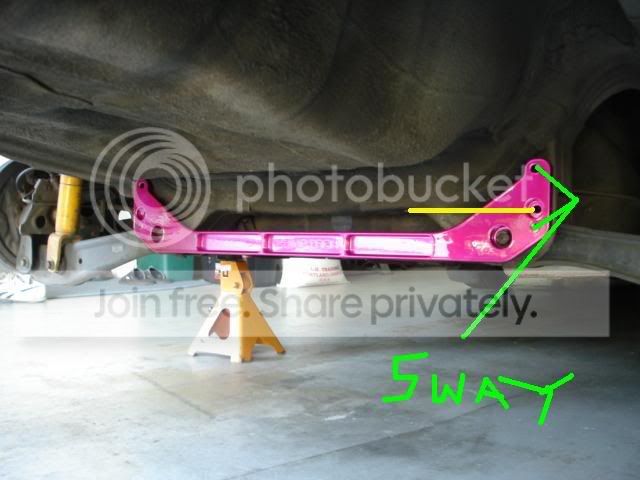

Ok so I just installed my brace and wondered what all the holes are for. I believe the holes marked in green are for the D-brackets correct?
Do I need to put nuts and bolts where the yellow line I marked is?
I am installing a 22mm ITR sway and would like to do it the correct way.
Fellow Comptech owners chime in.
Thanks in Advance guys.

The yellow hole should line up with the hole in the subframe where the lower D-bracket bolt would go using an SI bar (smaller bracket)
I havent used a comptech, but my asr kit came with pieces that went behind the subframe, and had a similar bolt arrangement to the one in your picture- two flush-mounted (green) holes outside a recessed (yellow) one.
If you have two smaller backing plates, the following should work. The top used a long bolt through the green hole, the D-bracket and the subframe, going into the rear plate, the middle yellow hole had a shorter bolt going through the subframe and into the backing plate, and the lower green hole had a shorter bolt going through the lower hole in the D-bracket and into the threads in the main plate.
hth
