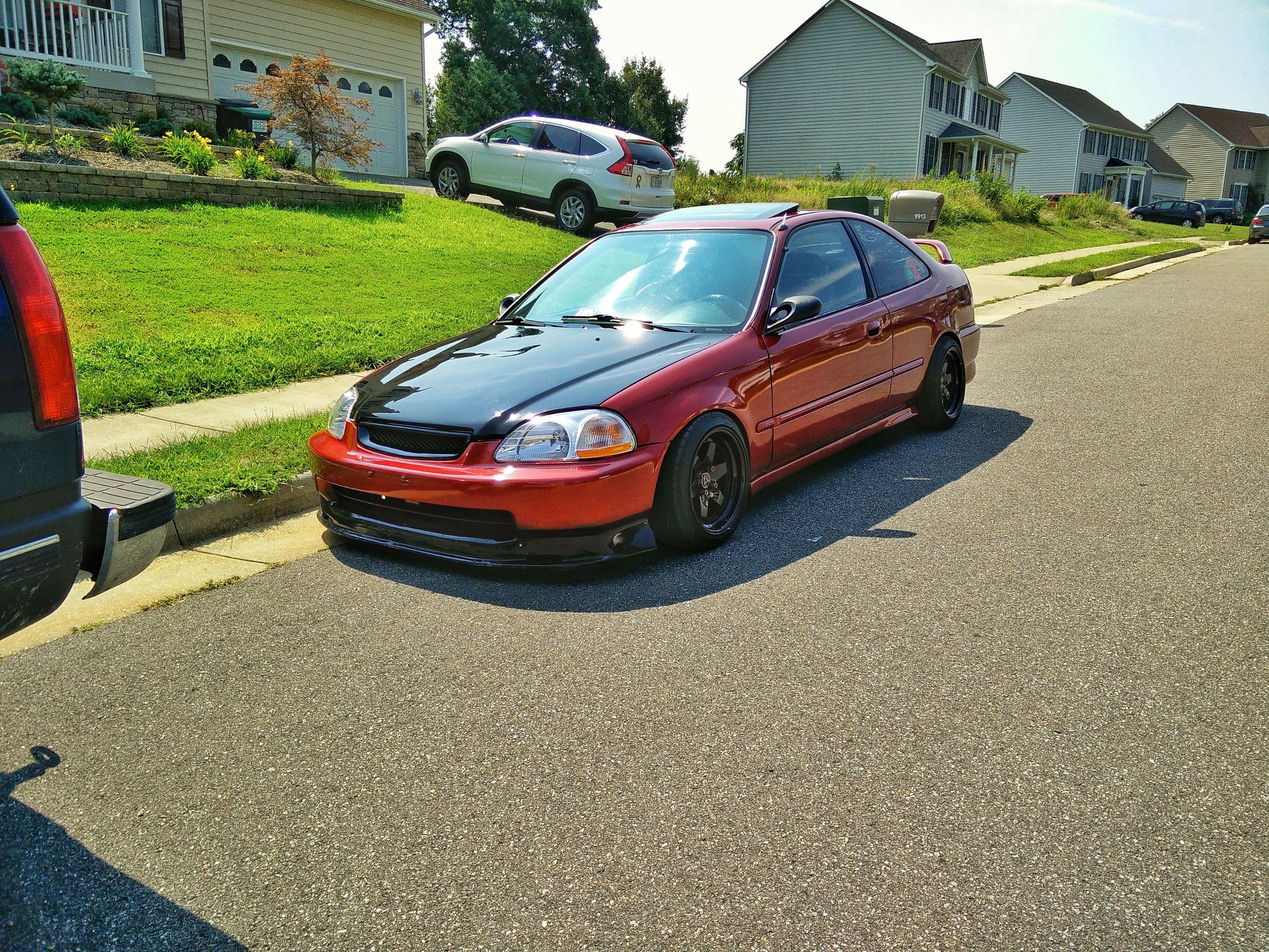

I like the hight of that hatch looks good man. So its gonna be either the Teins, D2s or Buddy Clubs... Im leaning more towards the Teins right now they seem to be what im looking for. Hopefully they will go as low as i want in the rear thats really my main concern.
Here's how my setup looks currently. Definitely want to be at least this low in the front and a little lower in the back so that it sits even with the front. But i also need it to ride better than it currently does... aka, not on the bumpstops. LOL
