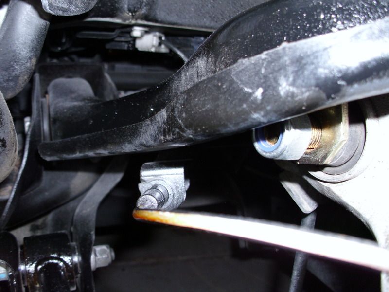

Step 14: Loosen the LCA and UCA bolts shown until the suspension goes limp and droops down.
Step 15: Clock the front bushings. Remember…not clocking the bushings is bad news.
-Put on a wheel.
-Jack up on the LCA till the wheel sits in the wheel well how you want. Measure this distance and write it down. I use the bottom of the fender to the top of the tire…or bottom of the fender to the centre of the hub.
-Remove the wheel. LEAVE THE JACK. Tighten the bolts from the last step. Then remove the jack.
