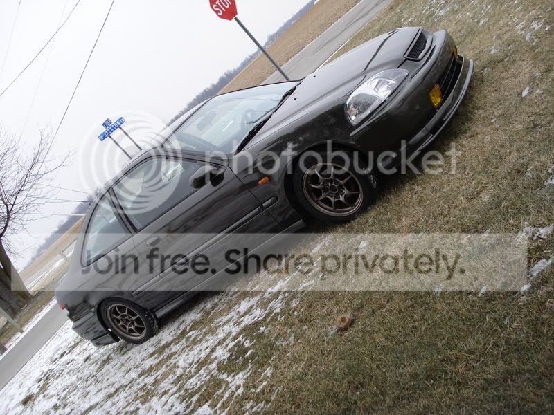

oh and here is a pic of the car with the old setup on it as a bonus
