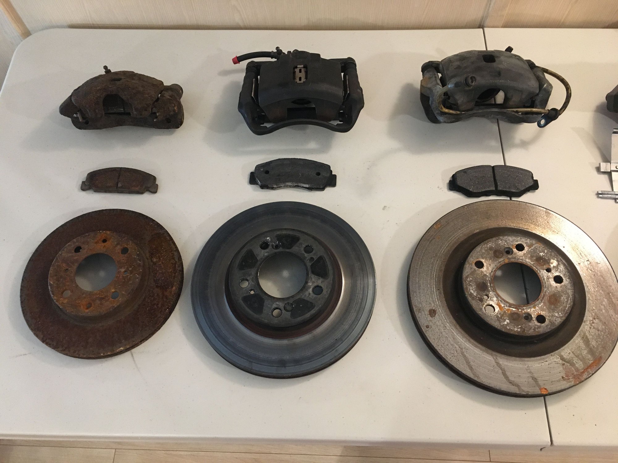

Honda builds all their stuff on a global architecture/ platform sharing on their models which means, Golden age Civic/Integra/CRV share a bunch of parts that may differ slightly but will bolt up to eachother...
Guess what? their newer stuff changed slightly but WILLL still bolt up if you know what's going on. For example DC2R knuckle, wheel bearings, wheel hubs are a glorified CRV components, with some minor differences.
So lets talk about the Civic brakes lineup, skipping 2001-2005 Civics/RSX because the caliper is trailing mounted where nearly every other Civic line is leading.
Starting with the RSX Honda moved to the smaller wheel hub flange when compared to the DC2R, RSX wheel hub diameter: 5.488" where the DC2R is 5.75". which means the RSX-S rotor will not fit over the DC2R wheel hub.
Rotor Size:
2000 Civic CX, 240mm diameter, 21mm thick, 4x100
98+ DC2R Brake rotors, 282mm diameter, 23mm thick, 5x114.3, 70.1mm register bore
RSX-S, 8th Gen Si, 9th Gen Si rotors, 300mm diameter, 25mm thick, 5x114.3, 64.1mm register bore
TSX rotors, 300mm diameter, 28mm thick, 5x114.3, 64.1mm register
TL-S Brembo rotors, 310mm diameter, 25mm thick, 5x114.3, 64.1mm register bore
2014-2017 Nissan Rogue with 3rd row Seat front rotors, 320mm diameter, 28mm thick, 5x114.3, 68.1mm register bore
Caliper:
2000 Civic CX, 51mm Piston
98+ DC2R, 57mm Piston
RSX-S, 54mm Piston
8th Gen Si, 54mm Piston
9th Gen Si, 57mm Piston
TSX, 57mm Piston
TL-S Brembo 4 Piston, 38/42mm Piston
2010-2016 Genesis Brembo, 4 Piston, 42/42mm Piston

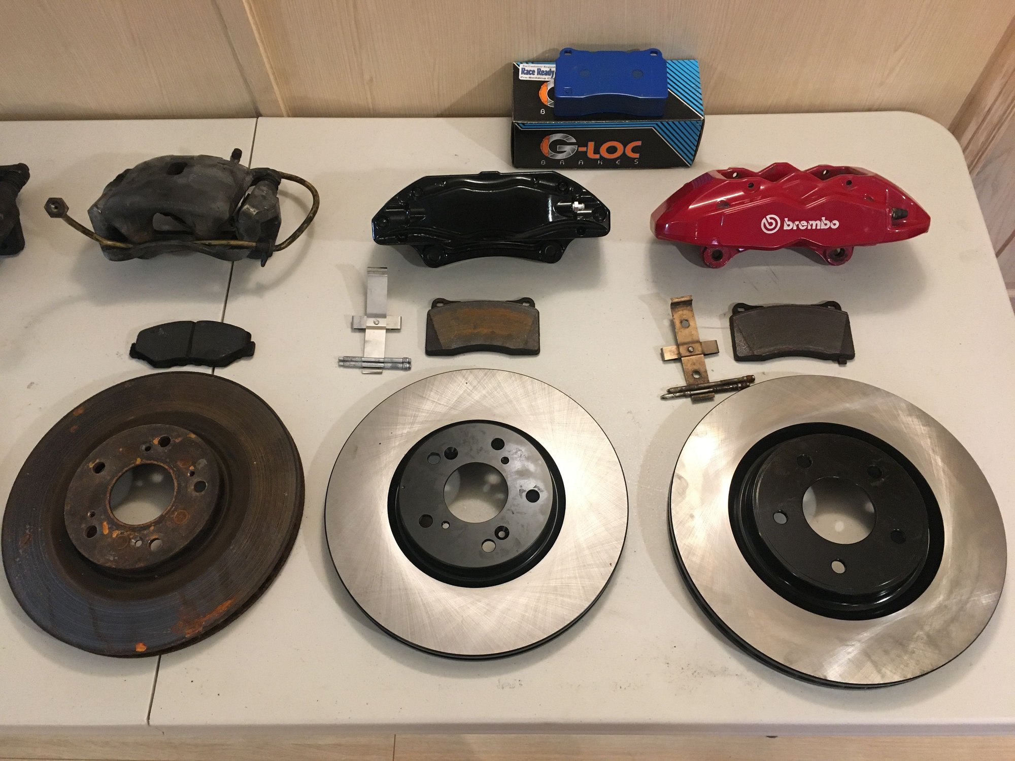

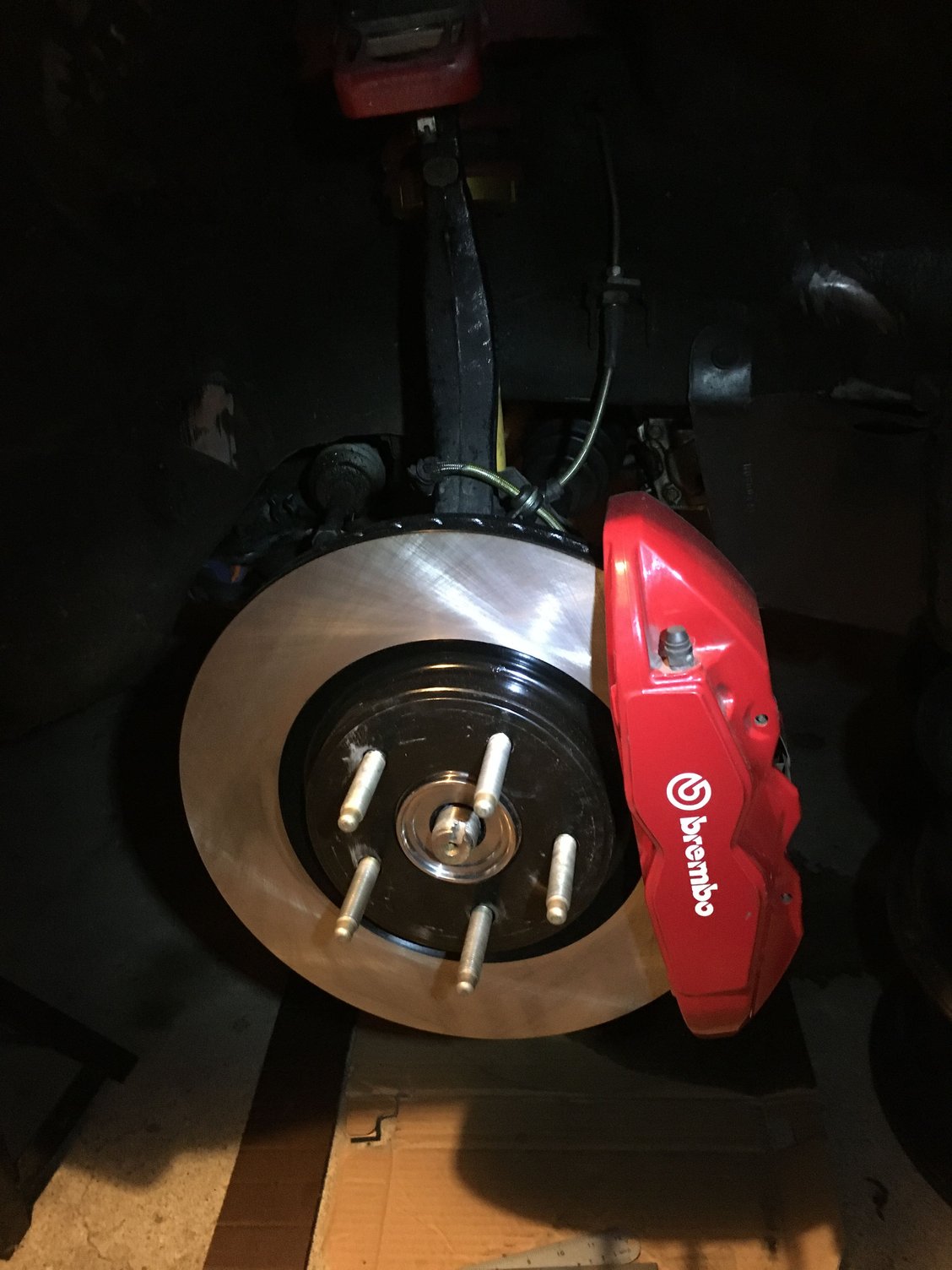

Surprise, if you machine down the DC2R wheel hub brake register size from 70.1mm to 68mm, BAMMM the Nissan rogue rotors sits in the center of the Genesis Brembo Calipers...
On this table, from left to right, 2000 Civic CX > 98+ DC2R > 9th Gen Si > TL-S Brembo > Genesis/Rogue Combo
Genesis Brembo with Nissan Rogue w 3rd row seat rotors on a modified DC2R wheel hub

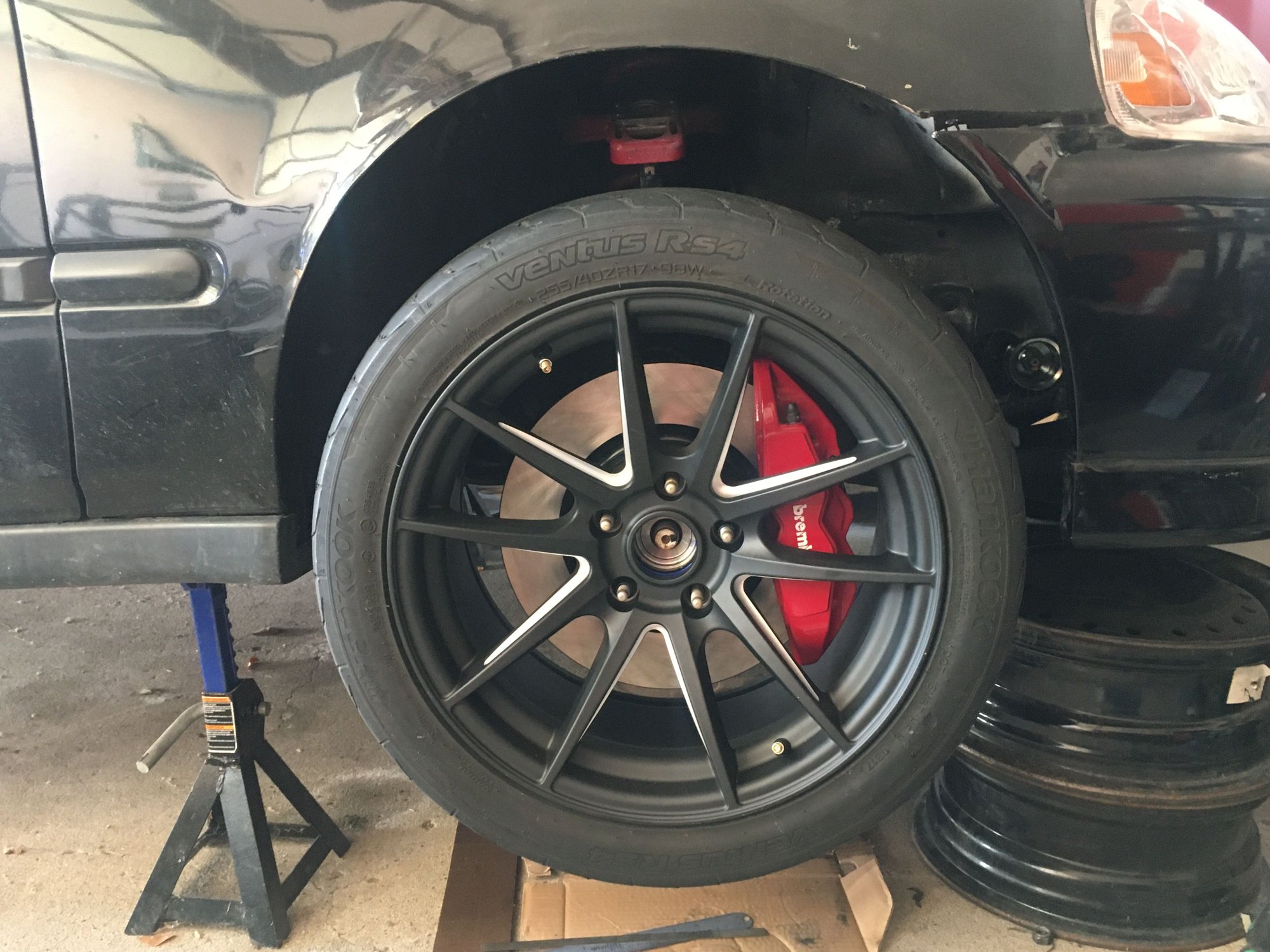

These things are huge, 17" RPF1 inner barrel does not clear the caliper, so I started looking around at other wheels, Konig Dekagram and Hypergrams in some 17" sizes will clear these.
Scot at Konig was super helpful and confirmed fitment after I sent him the CAD files for these, but at time of looking for wheels, the specs that I wanted were sold out, so more looking
Ended up getting a pair of 720form GTF1 17x9, 5x114.3, +25, which were very close to clearing around the spokes... so I added a 10mm spacer and now everything is looking good!!!
