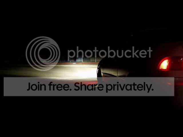

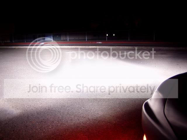

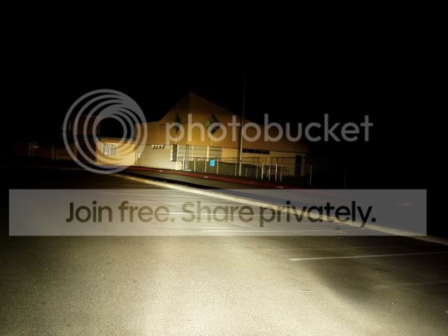

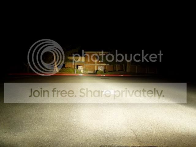

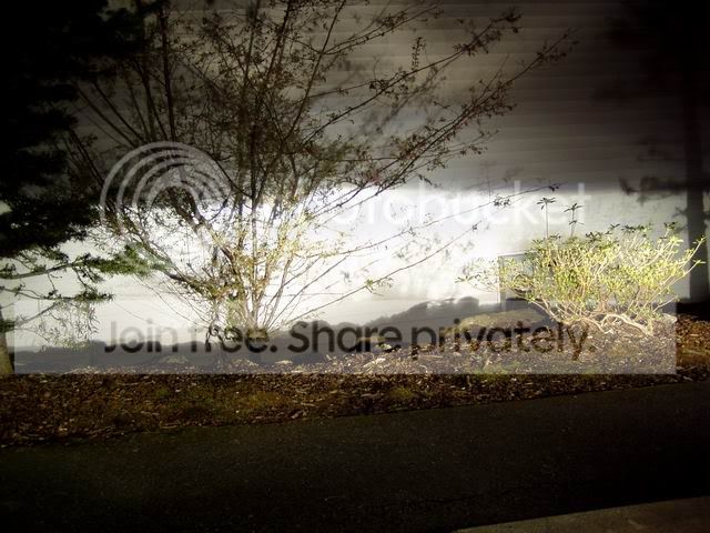

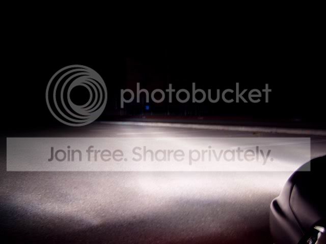

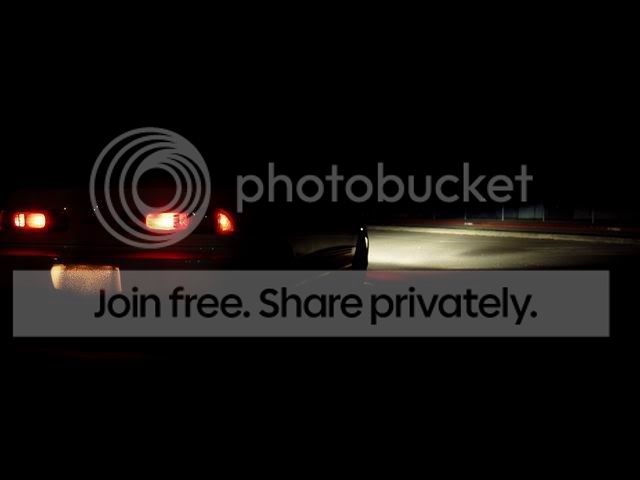

Posted this in the apearence forum, But i thought I'd Post here Well Went Last tonight... trying to take some pics of my New Bi-Xenon Set-up Still gotta do a Little aiming...
Hella Gen3 Ballast
4300 K D2s Bulbs
E-55 Bi-Xenon Projectors
Added some Daytime Pics
Only Beam Pattern SHot I could Get at the Moment
High Beam
Low Beam
Bi-Xenon Hi & Highbeam(9006) Mtecs Yellow
Took these This Morning
Modified by 96 Ls lnTeG at 5:43 PM 3/28/2004
Modified by 96 Ls lnTeG at 8:00 PM 3/28/2004

you can buy just ballasts, wiring, and bulbs modified to fit your stock reflectors. but the real way (and the good looking way) is to buy projectors along with all that. the projectors are what the bulb actually sits in and what puts the light from the bulb out onto the street. they replace the stock reflectors and you have to take apart your housing to put them in. expect to pay at least 400 for a kit with projectors.

160 Bi-Xenon Projectors
65 4300k D2s Bulbs
100 Another Set of Headlights
220 Used Hella Ballast
+160 For someone to do my retrofit an ship them back to me also
_____
$705 Plus if you wanna add my XenonDepot rebased kit that I bought, add another $420 so totals goto about $1125 you could save a few bucks if you did the retrofit your self
So yah do it right the first time I guess applies here
Plus in Ending a Rebased Kit compares nothing to a Retro-fitted set-up

I had a 400 Dollar Kit... I was not impressed The light was not as focused or as intense.. till I got my Bi-Xenon Set-up

Yep, I had a Visualdynamics Philips 4300K kit before in the stock projectors, and it's nothing compared to the light from OEM HID projectors.
For me:
$400 visualdynamics kit
$150 E-class projectors
$75 4300K Philips bulbs
reused my Philips ballasts from the Visualdynamics kit.
so about $625 for me total so far.
