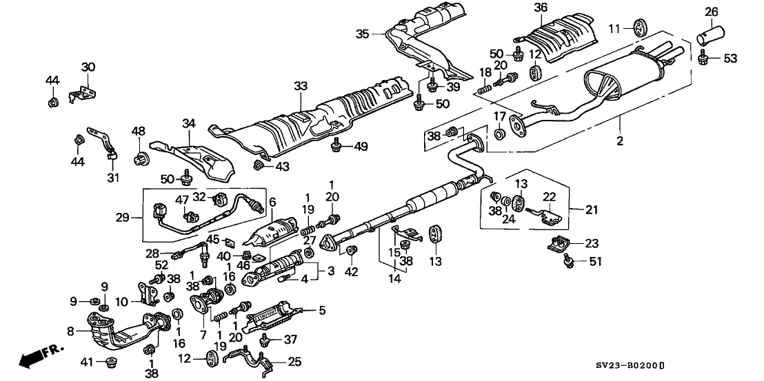

Note #24 part of #21 assembly...
That will come into contact with anything larger than stock diameter piping, just remove the nut and the damper, and make a racket off idle.
If the Magnaflow is the largest muffler you can fit in your rear section then I would look into the resonators and replace them.
Resonators will kill the drone/rasp.
Muffler will tune the tone of the exhaust.

My headers are stock but the rest of the piping is 2.25. So is that piece a spacer or what?
Problem with that mass damper is that it would only contact the exhaust under load, so free revving it in neutral showed nothing.
When the engine is under load the engine rotates and pulls the exhaust with it about an inch, the heavier the load the more engine(and exhaust) movement.
Getting the car up on a lift/blocks that allows about a foot of movement should be able to get you to find the location of where the rattle is coming from.
I've had a friend put the car in Reverse and then 2nd gear to load the engine a bit and get some movement. Only took a few minutes then to locate my rattle problem.
But you really need to trust your co-worker when doing the above.
