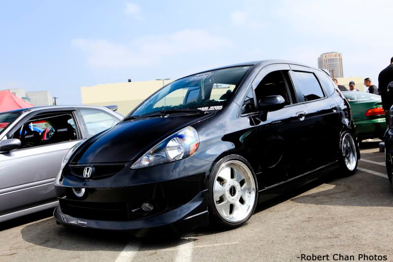

17x7.5 and 17x8 lowered on HKS coilovers + 195/40
Minimal rubbing, but I've rolled my fenders flat,pulled a little too, plus negative camber up front and in the rear
