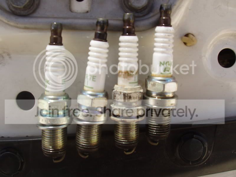

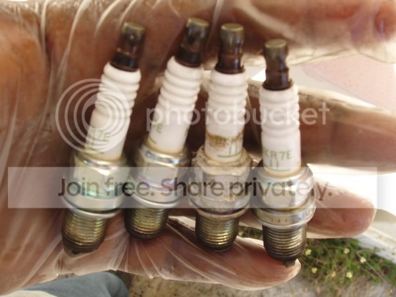

I inspected my plugs and number 3 plug lead was white upon pulling it of the spark plug. When I looked down the chamber for the plug, that one was white as snow from top to where the treading starts. It was also slack. would this cause my problem

I think that I found the culprit . The white one was not fully tightened.

i've seen plugs sometimes back themselves out with the combination of high compression and rpm. maybe thats what happened.

I changed the plugs, took it for a drive and it is still sputtering. But I noticed now that I have the time to look at the speedo that it is sputtering only when vtec engages.

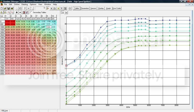

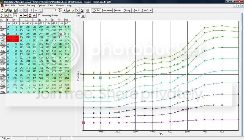

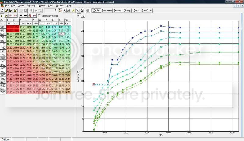

Post your pics of your S300 VTEC fuel and timing maps in 3D and in tabular form.

Okay the shape of the curves looks good.
1. Fuel numbers are on the high side for stock injectors. Your highest numbers (with no fuel trim) should be around 820 to 840 for a 1.8L.
2. Verify that you have 18-19 BTDC at idle. You can bump up to 20 BTDC and the car should run better.
Modified by Master of the Universe at 3:23 PM 2/20/2008

I use 310cc injectors. The ignition timing is 18*.

1. What is the fuel trim %?

it says that the overall fuel trim is 3%
