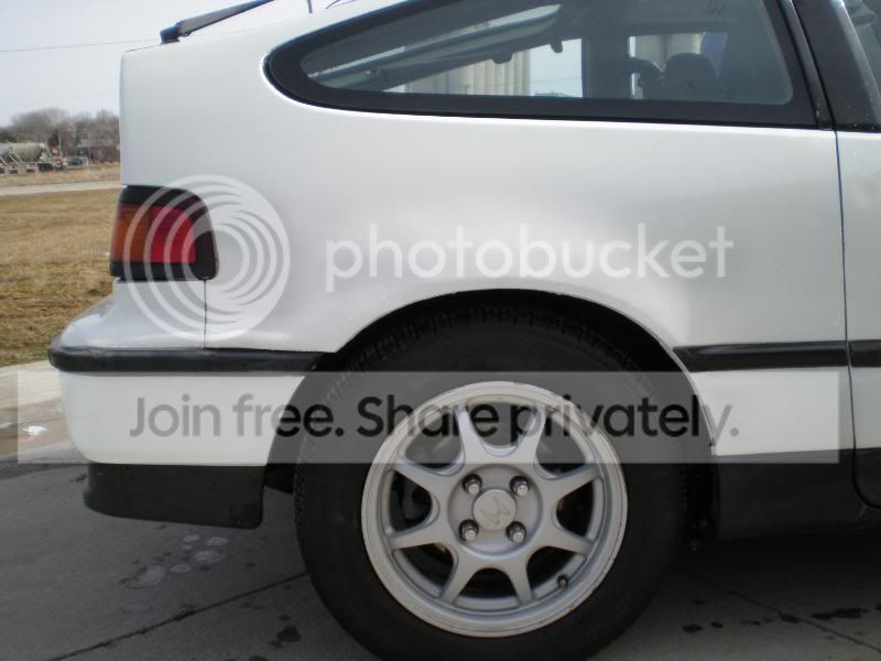

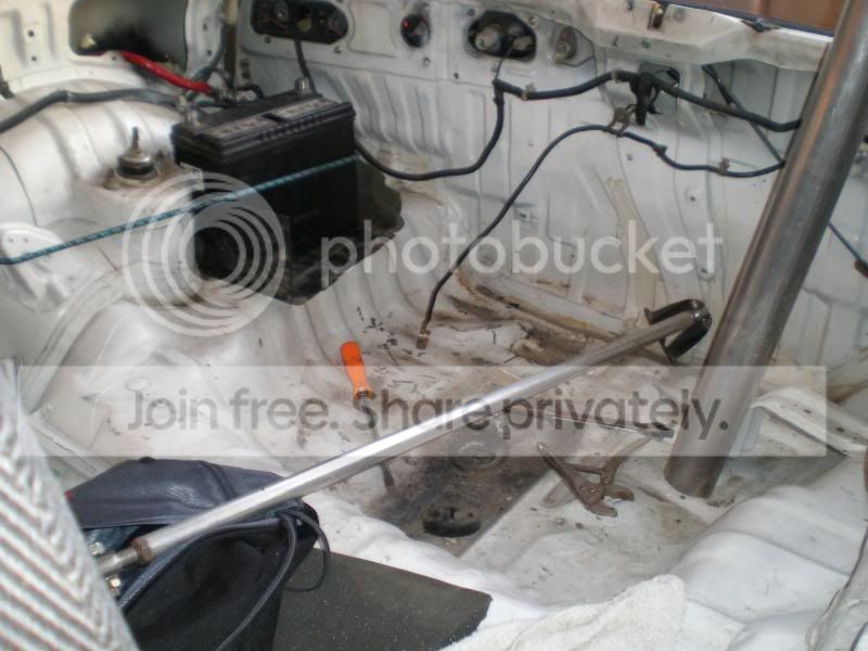

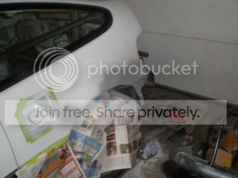

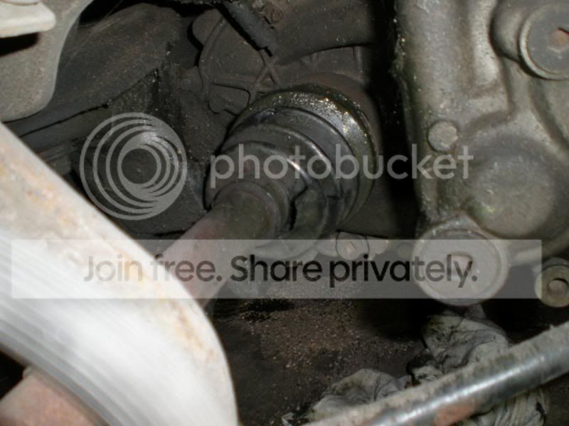

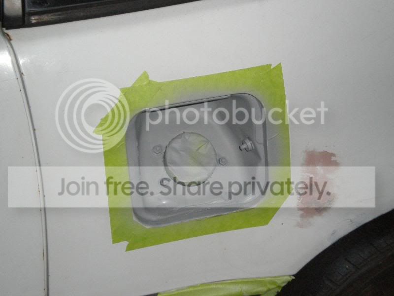

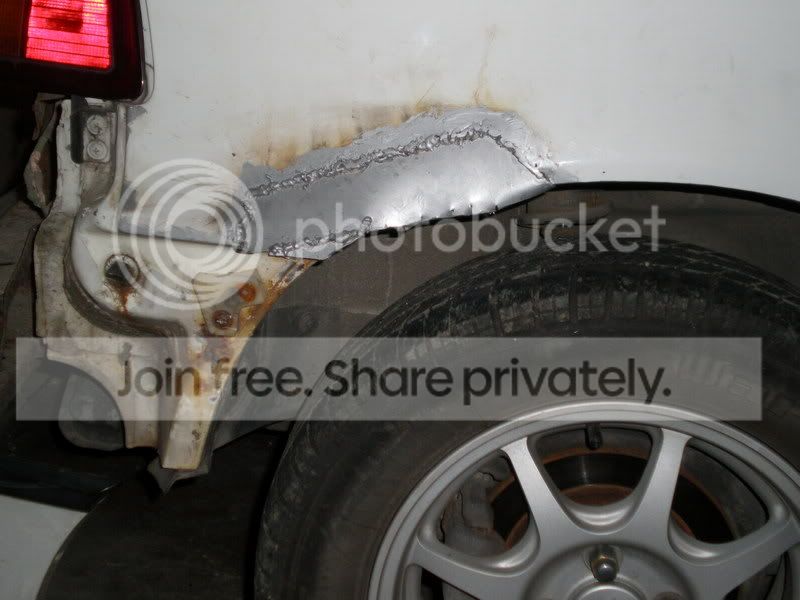

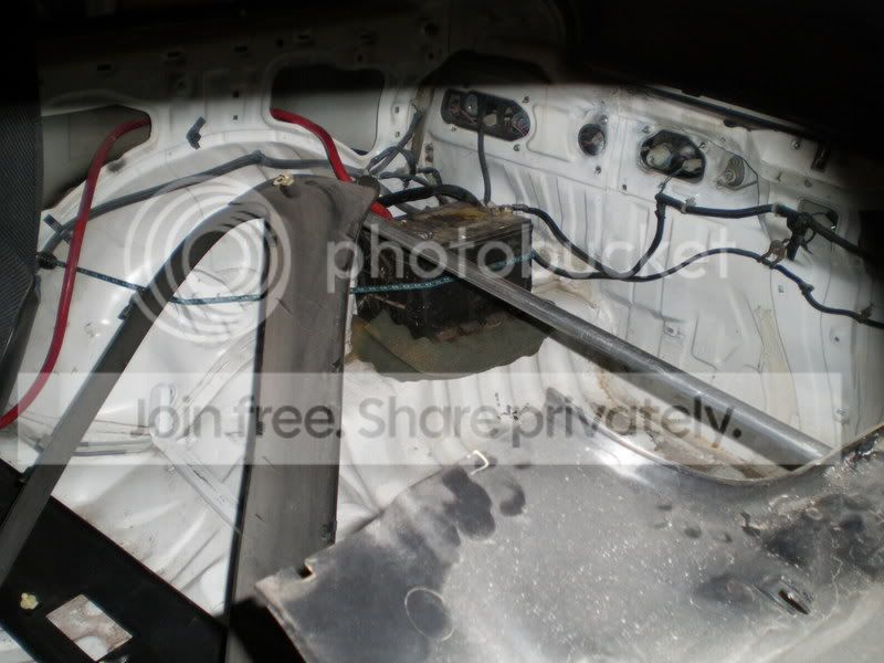

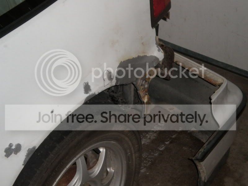

I picked up a 91 crx Si with an HMO b16 motor and S1 trans. Tein SS suspension on it, Rear Quarter rust (cut out and welded new metal First day I had it) Old school KAMAKAZI 4-1 header, Mini Wire-tuck, Battery relocated to hatch area Passenger axel boot is split,

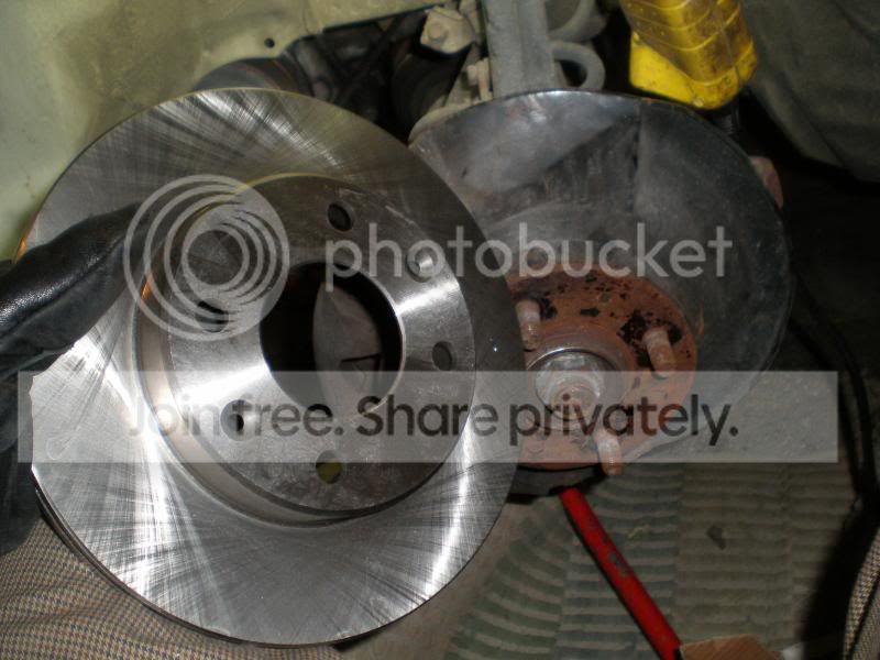

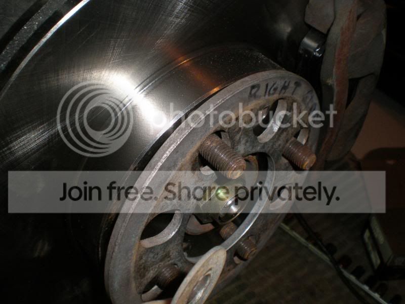

'93 Integra front break calipers, '95 civic Si rotors (brand new rotors installes with 0 miles on em, also Brand new Front break pads 0 miles on em)
Hasport Motor mounts New ball joints up front cracked windshield low miles 130,499 right now

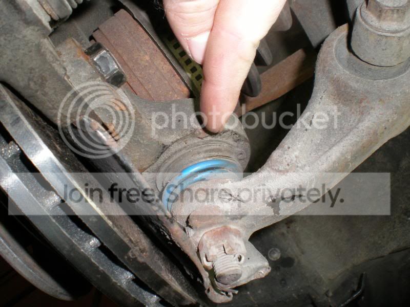

^ new joints
^ Split Boot

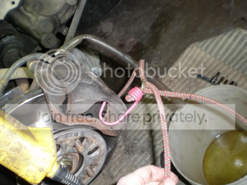

^ Bleeding breaks (those bungy cords come in handy )

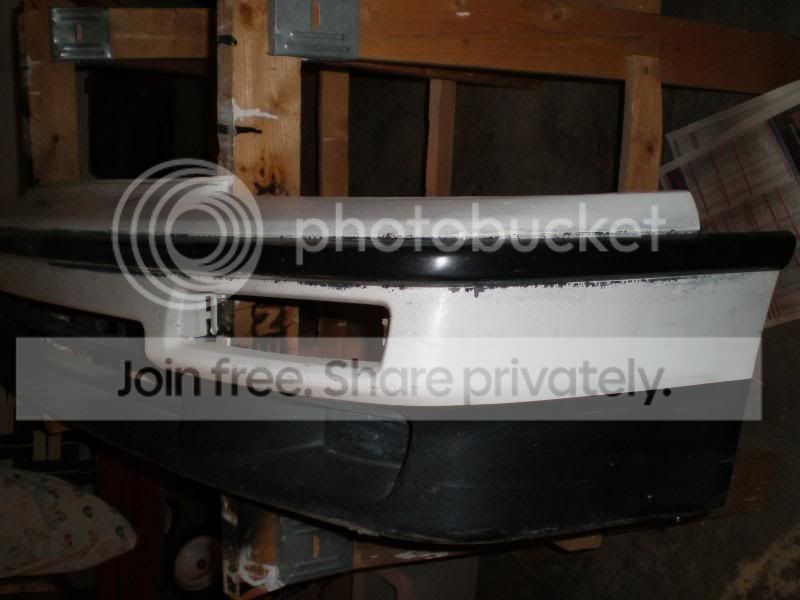

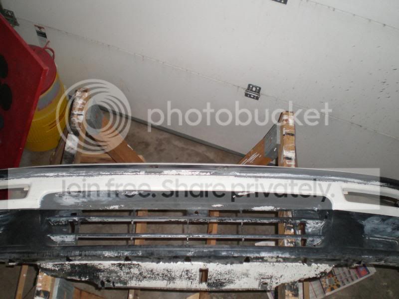

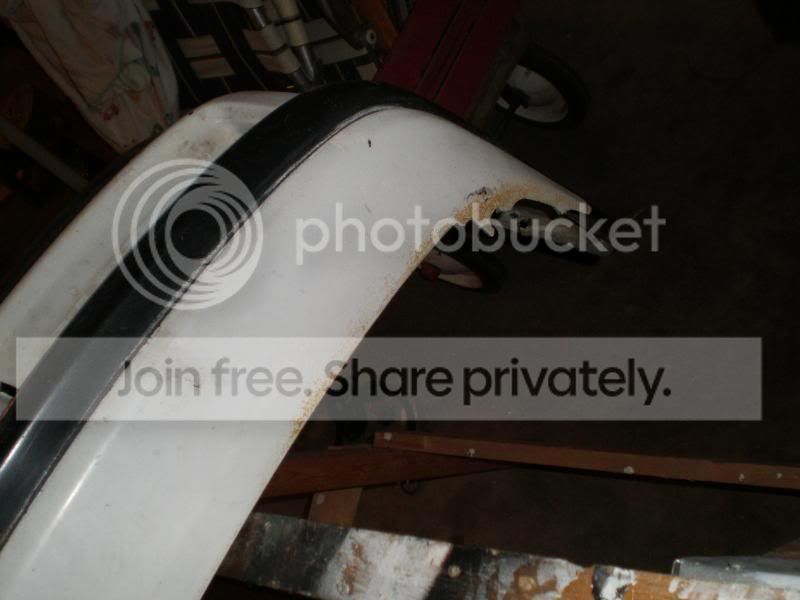

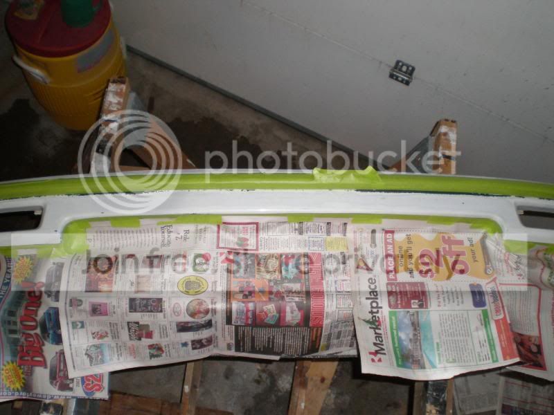

The front bumber sum how had rust on it So I decided i had to repaint it (this IS project No rust)
I will load up sum pics of the bumper and LIP when Installed

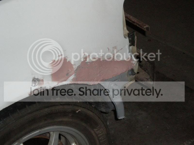

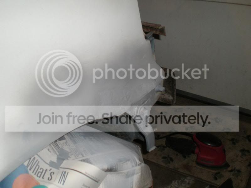

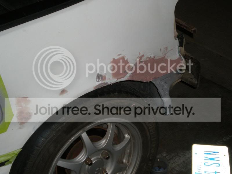

looks good, rust sucks... are you finished with the rear quarter or are you gonna do a bit more bondo/sanding?

Your rear quaters are kinda ruff. Looks like a good start though. Whatever you do FIX that battery. Having it in the rear isnt a bad idea...just buy one of those kits that comes with everything you need. Gool luck!

<TABLE WIDTH="90%" CELLSPACING=0 CELLPADDING=0 ALIGN=CENTER><TR><TD>Quote, originally posted by stunn’d &raquo;</TD></TR><TR><TD CLASS="quote">looks good, rust sucks... are you finished with the rear quarter or are you gonna do a bit more bondo/sanding?</TD></TR></TABLE>
Oh hell yes I am doind more bondo and sanding I have trouble gettin to sleep knowing its that ugly
They will look great When I'm done. I am just glad the car is White not black or red (otherwise every imperfection would stand out)

just making sure, you have it primered like your ready to paint

<TABLE WIDTH="90%" CELLSPACING=0 CELLPADDING=0 ALIGN=CENTER><TR><TD>Quote, originally posted by stunn’d &raquo;</TD></TR><TR><TD CLASS="quote">just making sure, you have it primered like your ready to paint </TD></TR></TABLE>
Thats so I can see the body lines better

<TABLE WIDTH="90%" CELLSPACING=0 CELLPADDING=0 ALIGN=CENTER><TR><TD>Quote, originally posted by ClubRX &raquo;</TD></TR><TR><TD CLASS="quote">
Thats so I can see the body lines better</TD></TR></TABLE>
Well, body filler sticks best to bare metal or more filler, make sure you sand it good before applying more. I don't bother with primer until It feels satisfactory, then if need be I will go back.

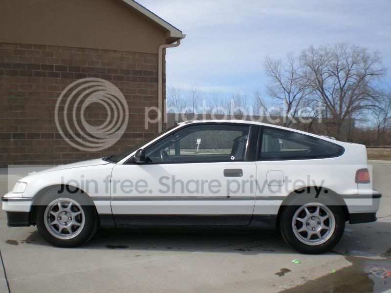

Finished!

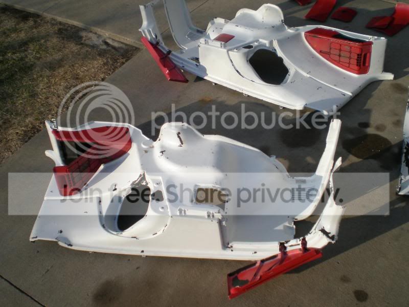

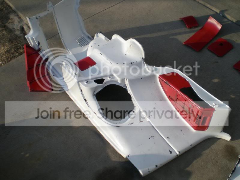

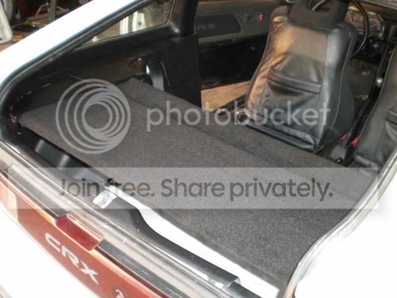

My latest project was the rear interior, You can see how there was no rear interior b4:
Picked up some ricer pieces:
Im goin 2 snap a few of what it looks like now in a bit, i'll give you a hint: SEXY

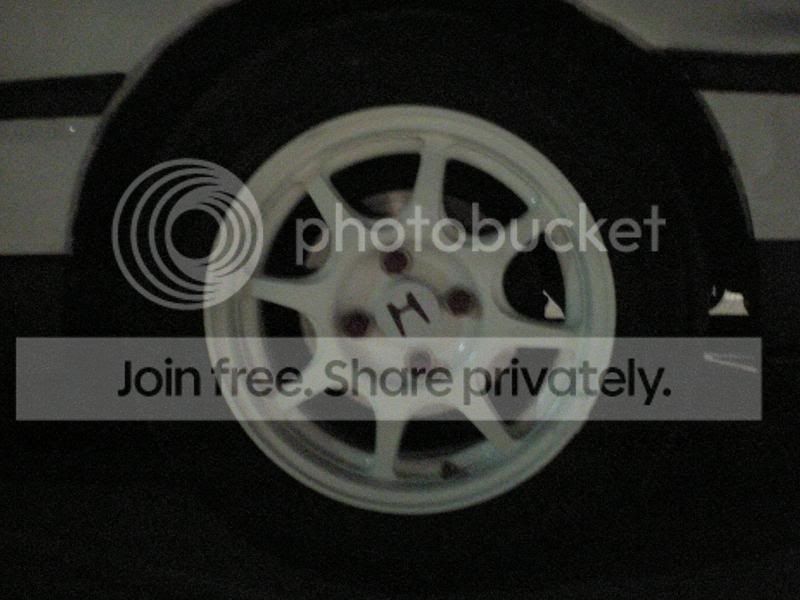

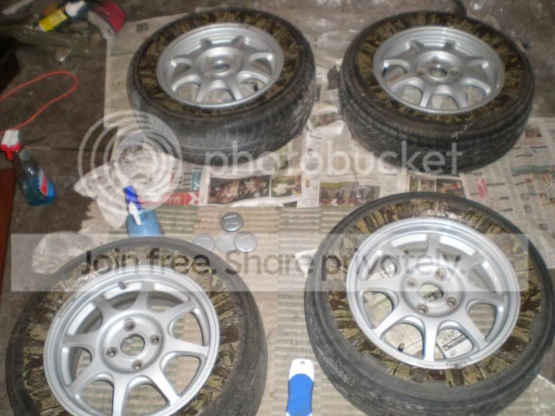

- Painted HX wheels white with read 'H' (Baby ITR's )

Found some pics of the new rear interior!
