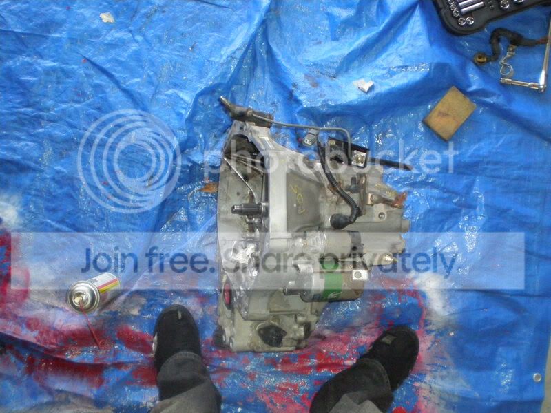

ex/si tranny, I've got one on the way to my house right now (ex that is)

my ex tranny just got in from nippon-motors, its in great condition and even came with a starter haha.

Lookin good bro!
Is that the one you got for $300? I'll take one too, please. :-p
Is it rebuilt or used?

it was 350 and they delivered it to my doorstep
it looks brand new and this one came from a JDM d15b, so far installing it tonight/tomorrow
