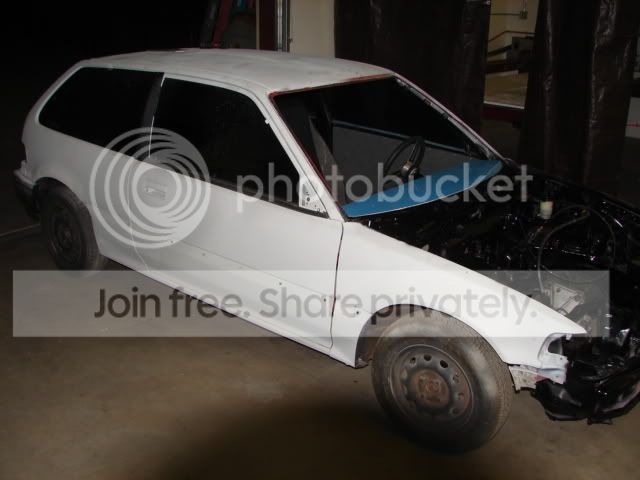

i am originally a small block chevy guy, but then i took a ride in a boosted civic(not a stolen one) and was blown away about how much power came from such a small motor. so a couple of years ago i got an 88 hatch, it was a pile of crap. i fixed it up a little and just drove it for fun hoping one to to build something way badass, last month i got another one 200 bucks, it was just a way bigger piece of crap and was covered in APC and pep boys junk. i decided to gut it to the bone and make a drag car out of it, but still drive it on the street. dont have many pics right now but i will keep ya posted
here it is
i guess that is white primer on the car, someone did a terrible job on it, but at least the body is pretty straight.

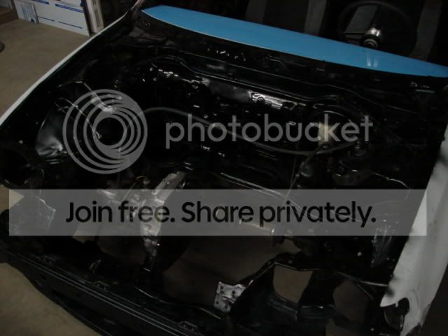

cleaned and painted engine bay-and stripped it down some more-sorry bad pic-

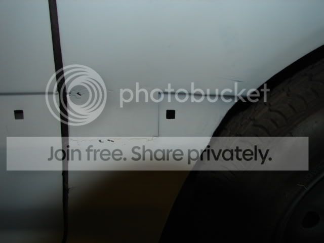

not real sure what the hell this is? sorry attempt at filling the groove? probably gunna put fiberglass fenders on and stock body moulding back on, maybe some jdm bumpers.

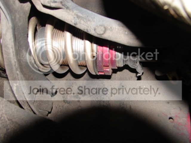

ya gotta love the ebay coilovers! probably gunna go with tokico, they seem reasonable and i have heard good things bout them
