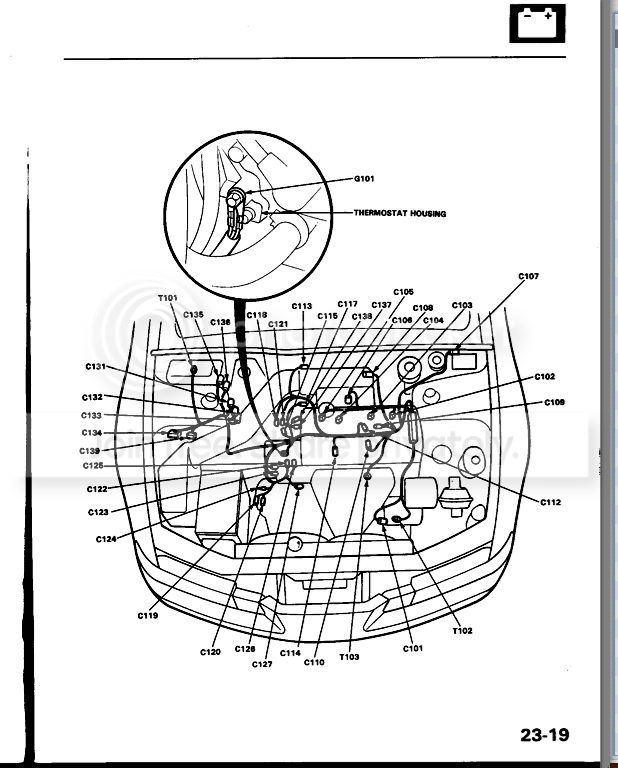

Old Oct 19, 2007 | 08:24 PM
LukieLuc's Avatar
Posts: 1,453
From: Nyack/Stony Brook, NY, United States
Default Re: (prelude-all-the-way)
Old Oct 19, 2007 | 08:28 PM
LukieLuc's Avatar
Posts: 1,453
Default Re: (LukieLuc)
I think you are looking for T101
Old Oct 19, 2007 | 08:29 PM
prelude-all-the-way's Avatar
Posts: 314
From: ok, usa
ok thanks the alternator has a sub wire coming to it so it could be a short ill give it a try wish me luck
