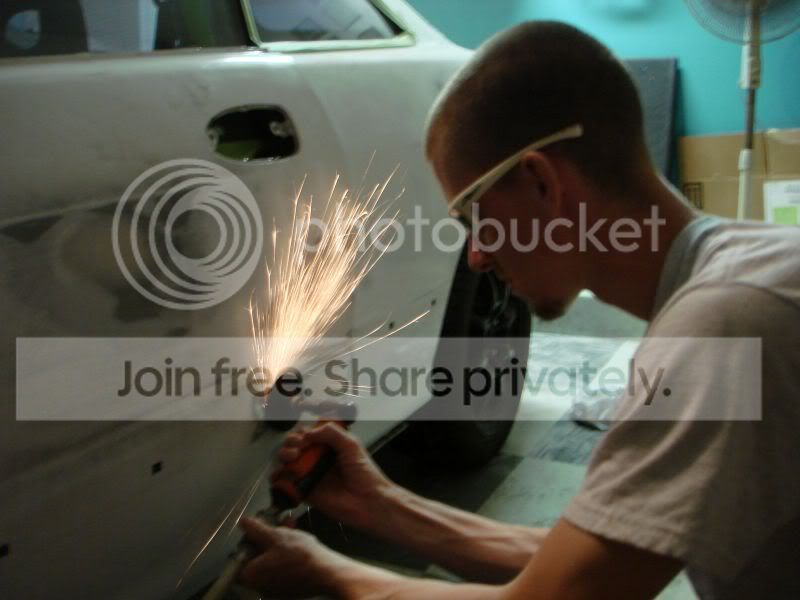

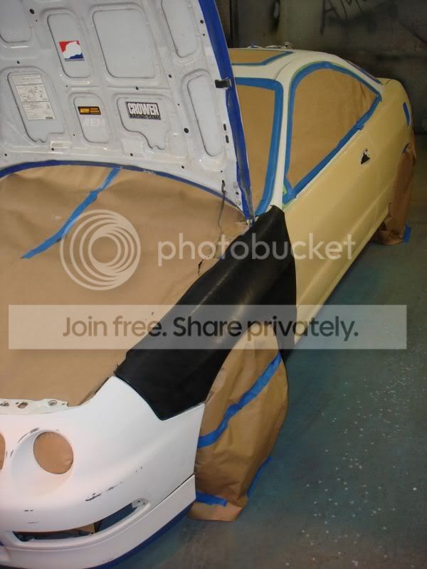

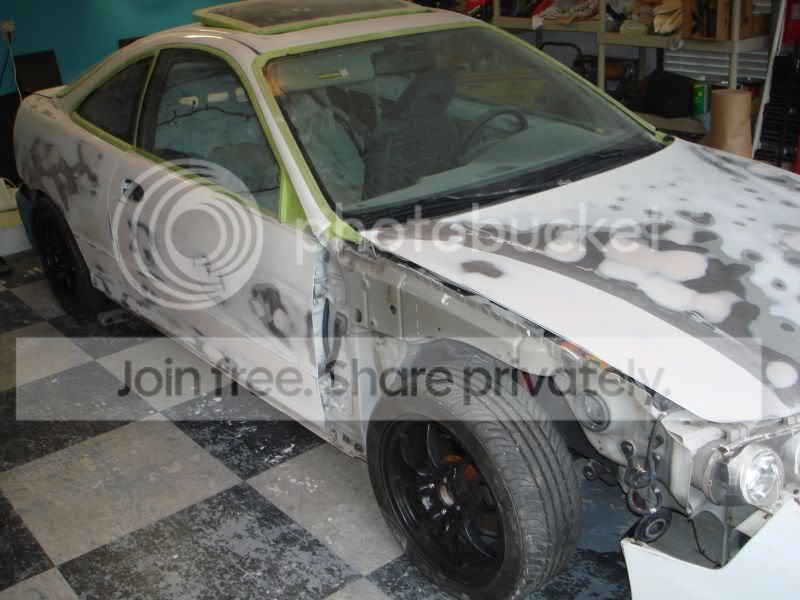

Default Re: (nix94delsol)
I welded all of my molding holes. We put pieces of metal behind the holes and welded from the front. Then grinded down all the excess (sp?) metal and used Rage Extreme body filler to even it all out. I'll post some pix in the next couple days to give you an idea.
Old Aug 17, 2007 | 06:43 PM
DeltaCharlie2's Avatar
Posts: 158
From: Northeast FL, USmuthafknA
Default Re: (DeltaCharlie2)
This is after just starting the welding and grinding
First layer of body filler laid down
Primered
Sealed, painted, cleared
