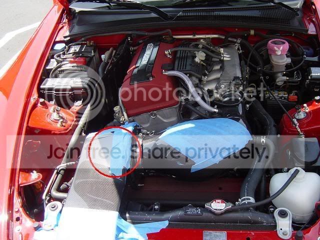

In regards to the J's and Mugen intake (the only ones worth a mention IMO) modifying the hood isnt a big a deal as u may think. With the right tool and know how its a few moments work.
Also both being CF and shielded it wont be subjected to heat soak like the ARC box or a pod on the end of a pipe, no matter what its brand. If theres no heat soak,temp is kept down, if temp is kept low then the ECU is kept happy and ignition wont be retarded. This will equal higher and constant HP. These intakes not only make power (how ever little it may be) they also preserve power.
The mugen intake does not require the mugen hood or bumper to work well.

<TABLE WIDTH="90%" CELLSPACING=0 CELLPADDING=0 ALIGN=CENTER><TR><TD>Quote, originally posted by WhiteAP1 »</TD></TR><TR><TD CLASS="quote">In regards to the J's and Mugen intake (the only ones worth a mention IMO) modifying the hood isnt a big a deal as u may think. With the right tool and know how its a few moments work.
to add to this.... the aem and injen also need some modifications to fit.... the fender liner must be cut for the placement of the piping and filter.....
for further elaborate.... hydro lock isn't a big issue if the right percautions are taken.... there is a hole on the fender/engine bay that need to be covered and you should not have any issues with hydrolock.....(speaking of which i need to take a picture of the hole for someone......)
The mugen intake does not require the mugen hood or bumper to work well. </TD></TR></TABLE>
I have a couple questions about the J's piece since you seem to know a little bit about it. This is a rather simple question, but I have looked at the J's quite and I'm still unsure about where/how hte intake filter sits. I'm assumring the intake filter sits in the same location where the AEM intakes sits, would I be right on this? Also, if it is in the same location, is it covered much like the comptech box to prevent from any hydro locking issues? Lastly, on the topic of cutting the hood, how much does the hood need to be modified for the intake to fit? Does this cutting hurt the actual resale value of the vehicle? Is it even that noticable? I would just like to know a lot more about the cutting of the hood, before I would purcahse such an expensive piece. Everyone states that the cutting isn't bad, but in reality that doesn't give me any insight on the actual cutting. Any help would be greatly appreciated. Thanks.
<TABLE WIDTH="90%" CELLSPACING=0 CELLPADDING=0 ALIGN=CENTER><TR><TD>Quote, originally posted by ITR0065 »</TD></TR><TR><TD CLASS="quote">Does the snake looking thing then just have an opening at the bottom?</TD></TR></TABLE>
yes, it's opening is larger than the spoon intake and it's thicker over the radiator support than the spoon intake
