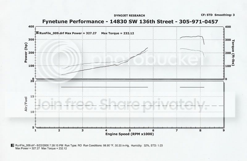

After 9 pulls the numbers were 327whp/232tq @ 11psi.
The timing was not touched, except for the usual Crome pro step retard. Tuning was done by Herman from hermsfab.com using Crome pro.
Here is the sheet:
<U>(The RPM pickup was acting up, which is why you see the break up in the graph. We couldn't put the a/f sniffer so we just went by the PLX wideband readings.)</U>
A/F's were kept below 11.9's

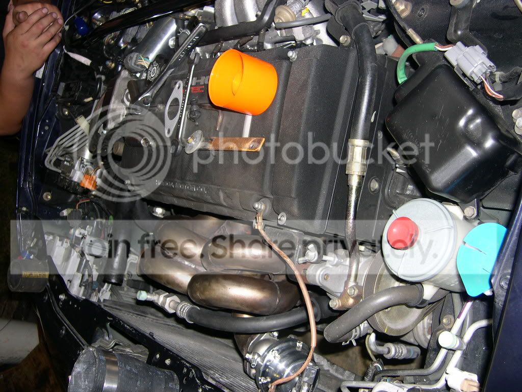

<TABLE WIDTH="90%" CELLSPACING=0 CELLPADDING=0 ALIGN=CENTER><TR><TD>Quote, originally posted by CAN97SH &raquo;</TD></TR><TR><TD CLASS="quote">That's pretty awesome from a stock block.
Any pics of the setup yet? </TD></TR></TABLE>
these are the only pics I have... sorry for the size.
