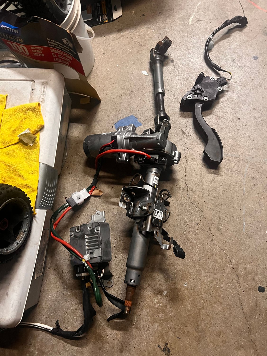

i yanked a prius electric steering column. Going to retro fit it when the season dies down

Made some progress on the prius electric column.
The steering yoke from a honda shaft works on the prius shaft so no welding needed there where it meets the pinion

Getting closer to getting this electric column to fit. I havent had to cut or weld anything just swap the spindle at the pinion.
Im going to have to shorten the lower shaft and fab a simple bracket to hold a stud for the electric motor.

Just gotta clean up the wiring and shes about done. I might move the controller to a different spot.
This is a power steering rack that is disconnected. I had to use two hands to move the wheels just like this in the garage.
Im hoping this helps me have a smoother control in cornering
