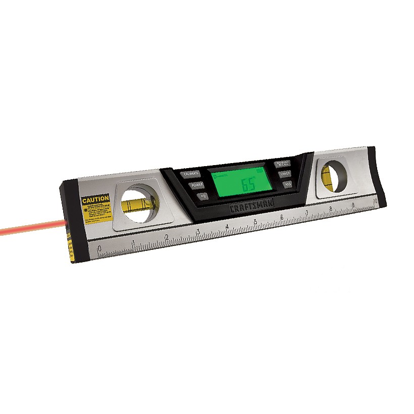

ive used longacre toe plates and confirmed it with a firestone alignment right after and was within 1/32.
now instead of using strings to align the rears to the fronts, i used the laser pointer method. its pretty simple and you use the longacre toe plates.
http://www.sr20forum.com/techn...39018
i bought this one for $30 on sale. i think its $35 right now.
works great.

I am looking for a cheaper way to do alignments also. I understand the camber method, but can you explain the toe measuring method, specifically how you know that you are parallel to the centerline of the car please?

just as it shows in the pictures. you point the laser against the rear tire and shoot it forward. see how far it is from the front wheel's edge, say the axle end. record that measurement. then do the same thing on the other side. if theyre equal, no matter the value, the rear wheels are centered to the front wheels. if one side is pointing further away from the fronts, then you know which direction the two rear wheels need to adjust until they equalize.
