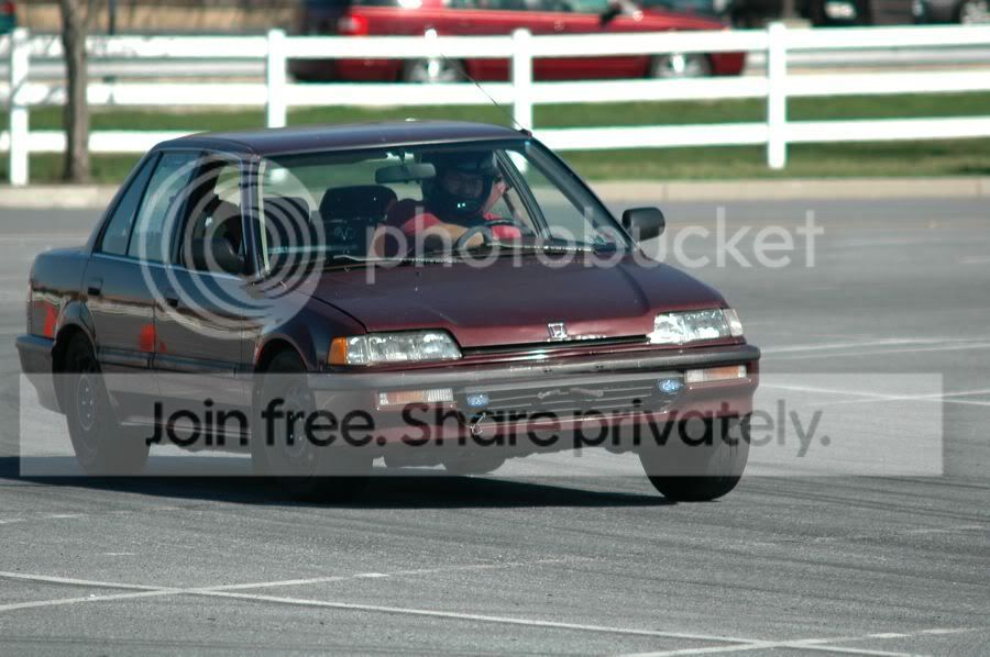

yeah, well you don't drive this. and it actually worked out pretty well. rotated just fine. better then i thought.
[IMG][/IMG]
