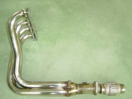

look on egay this is 180 with a 2.5in collector
then go to coastfab.com for the muffler

The way, I interpret the STS rule was that, as long as you keep the stock CAT, you can change anything on the exhaust system.
The above picture seems to be that of a JUN header. There is another JUN header in ebay for $245.....
http://cgi.ebay.com/ebaymotors...=WDVW
I thought JUN and DC headers are all relatively equal???

i'd have to recommend against that header.i have some experience with the SSAC 4-2-1 header,where all the flanges are so warped/irregular that none of the connections seal-and i mean "sounds like it's running an open header" kind of leak.i'm sure they spend tons of money on R&D to tune it too.
if you're getting a header,spend some money for something nice and proven,otherwise leave it stock.
