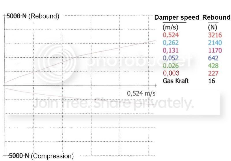

Is there any advantage with linear shock valving? Why do so many Japanese shocks use it?
(and a slightly ot question: the guy who dyno'd these bought them so that he could have Bilstein's revalved to these spec's. Any reason for someone to do that instead of just using the OEM shocks?)
Brand new OEM NSX dampers:
Btw, what's going in the second graph? There are two curves, neither of which start at 0 N.

Possibly because the owner believes that Bilstein uses higher quality components that will provide more consistent performance over a longer period of time. I believe Bilstein's are user serviceable too but I'm not positive.
The second graph shows force vs absolute velocity. Due to internal pressure changes and the speed at which the piston is moving during a typical dyno test, the piston is never truly generating 0 force, and remains at 0 velocity for only an extremely short period of time.

What do you mean by absolute velocity? The entire damper isn't moving, only the piston. Is the first graph supposed to be relative velocity then (which wouldn't make sense..to me).
Why are there two (four) curves?

it isn't very clear dyno to begin with so it wont be easy to really tell anything with certainty.
A the graph is just like any other graph, if you scale it down enough, or zoom out enough everything looks linear. I do see a knee in the graph so it isn't really linear. With out a more labeled and detailed graph it is pretty hard to tell.

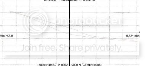

The labels seems perfectly clear to me. The max value on the velocity axis is .524m/s and 5000N on the force axis, each divided into five points. What other labeling is required?

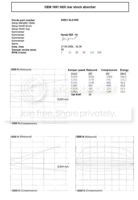

Here's a clearer view. I don't see a knee in the front damper graph at all. Even in the graph of the rears, the knee isn't what seems like would be high-velocity on koni graphs.
Front:
Rear:

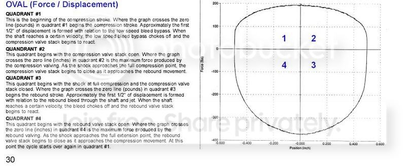

The first graph is Force (N) vs. Velocity (m/s) and the second graph is Force vs. Shaft displacement at a fixed velocity where each trace is run at a different shaft velocity.
By second graph, I meant the one at the bottom left. I realize the bottom right is displacement v. velocity, but the bottom left is labeled like the first.

Absolute meaning there is no "negative" values in piston velocity, they are all measured on a positive increasing scale. There are only two curves. The one you have posted is the force vs absolute velocity curve, and the one above is the force vs. velocity curve, which is just the force vs. absolute velocity curves mirrored. It is easier for some to understand what the graph is showing if you give them the f vs. v curve.
The f vs. v dyno shows the behavior of the shock with the valves open and closed in both compression and rebound, and the difference you see in where they cross the y-axis is again due to internal pressure changes - never totally equaling out on either side of the piston.

That's fine, but what's the difference between the top graph and the bottom left? They're labeled the same way.

The top one appears to be a simple force vs peak velocity curve that we are all used to seeing. You set the dyno to crank at a fixed speed and you get the forces generated in compression and rebound at that speed. You plot the two data points, and then do it again at a different speed and get more data points. Then you connect the dots and get a graph. Since the data acquisition starts at zero velocity, then there is no force being generated and the points will be measured from 0 on the y-axis. The bottom graph has data points collected during the entire cycle of a shock as the dyno cranks it through compression and rebound.
edit: in fact, that is also explained much more clearly on Roehrig's page. you should probably just read what they have instead of trying to figure out what I wrote - they have diagrams too, which is helpful.

I would assume that the difference between the top chart and the bottom chart is that in the top one the force from the pressurized gas in the damper has been removed (subtracted out) while in the bottom one it has not. If you leave a pressurized damper disconnected, there is a steady force that pushes the shaft out of the damper. This force is F=PA where the Pressure times the piston Area gives a constant force independent of the position of the piston. Thus in the damper stroke, when you pull up on the shaft (rebound), you don't need as much force since the gas pressure is helping you get the shaft to extend. That puts the zero point below the axis. When you push the shaft in (bump), you have to add force to overcome the gas force and this moves the zero above the axis as you need a steady force to hold it in any position (otherwise it will just extend out to its limit by itself), giving you the bottom chart. Then just subtract/add off the constant force depending on motion direction, say about 200 N in your chart to get the typical chart like the top one. This gas pressure helps support the weight of the car like a spring in some sense, but it is a constant force independent of damper shaft position. It can be used to tune the handling in some dampers such as Moton, JRZ, Penske, etc.

Looks like Al was onto it. Found a pretty simple explanation in the Penske manual:
Can someone please explain this, because I haven't been able to find the answer anywhere. What is the biggest advantage with linear valving? When is it used? These are general questions.

the non-zero start is most likely that the damper is a monotube type, which will exert a static force due to the gas inside.

The difference is due to hysteresis, and hysteresis will be present whether you have a gas-pressurized shock or an emulsion type shock. OEM NSX shocks are twin-tube.

From Roehrig dynos: WHY THERE IS A FORCE VALUE AT ZERO VELOCITY
