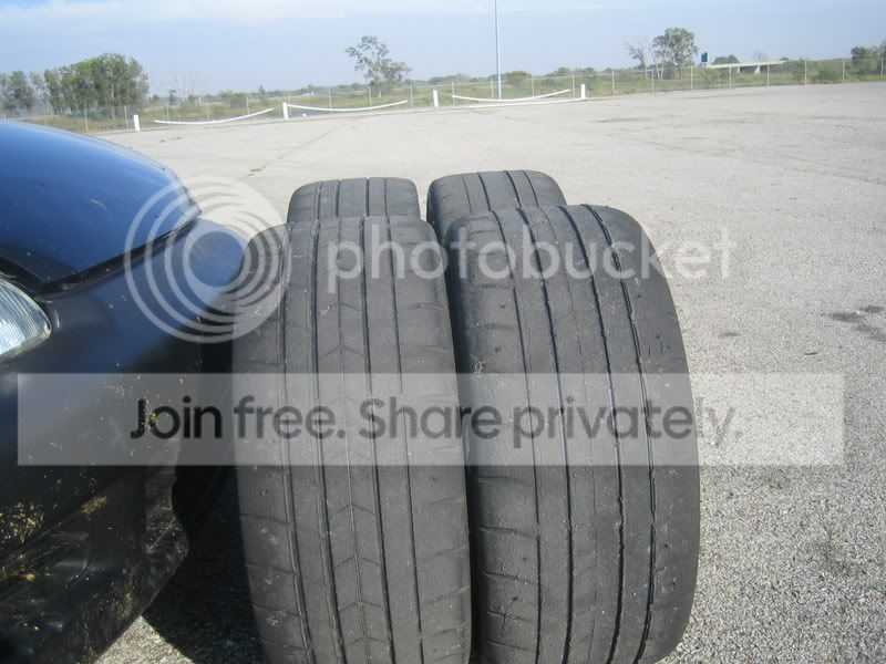

After 1st day:
the ones furthest away are the ones I used on the front. 4 heat cycles
Here the ones nearest are the fronts, pics at the same time.

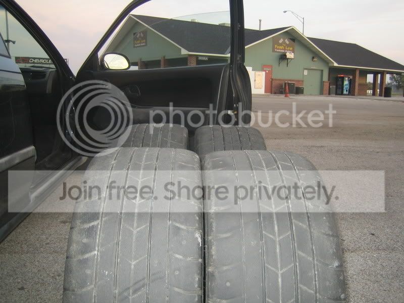

2nd day: Pretty it was a wet track for the first few sessions and then heated up to maybe 70deg track temps towards the end. 30-40mph winds!!
The ones furthest away are the fronts again. I rotated the rears to the front for this day. 7 heat cycles later

After 1st day:

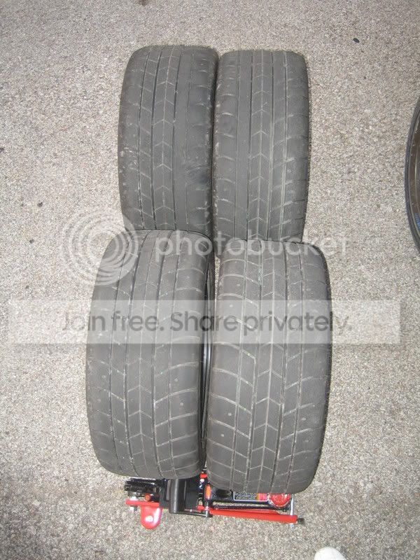

graining is when the rubber of the tire rolls up on the sides of the tread.
about the tire pressures, they were a little funky for me. I put 35 in the front when they were cold, and when I got off track, after going through the cool down lap and throuhg the pit lane and parking back at my spot, they were back at 35 psi.
<TABLE WIDTH="90%" CELLSPACING=0 CELLPADDING=0 ALIGN=CENTER><TR><TD>Quote »</TD></TR><TR><TD CLASS="quote">
there is a good example of the graining. see the tire on the right side, and the tread on the right side of that tire, how it is raised at the edge of the tread?

Full tread RA1s do it . Its like the rubber just peals away. I think it is a non issue most of the time when the RA1s are shaved and/or are worn past the tire tread pattern. At least I hope so. This is my first set of R comps.
Graining = "Feathering" to others as well.. . Graining doesn't really seem like the correct term to me but I knew what you meant DREWBIE.

Tires need more heat, camber & pressure. As a general rule, those tires should be around 38-40 psi hot coming off track even with a cool down lap. Wear looks too even across the face to be getting max grip thru corners. Add more negative camber.
I have experienced the feathering effect even with correct tire temps & hot pressures if there wasn't sufficient negative camber.
Yes, full tread RA-1 are more prone to this effect/condition than shavers. We only run full depth for RA-1s for rains.

The OP is going out with 35 and coming in at 35, something is up here.. .
I'm not sure when the OP is getting track time but I guess the advice here is either
1.) just hot pit.. . hopefully you have a friend to help out
2.) if you don't and you can still go slow on straights and fast in corners without using the brakes, you should be fine figuring that your tire pressures are probably 1-2 PSI lower after one mildly aggressive cool down lap.
<TABLE WIDTH="90%" CELLSPACING=0 CELLPADDING=0 ALIGN=CENTER><TR><TD>Quote, originally posted by 6spdKEG »</TD></TR><TR><TD CLASS="quote">okay, last words about the "cooldown lap" If the darn course is HOT and I'm cooling down.. . I'm mainly cooling down my brakes but I'm never runnin hot engine temps or too hot of oil temps. I'm not going into corners at high RPMS and usually not in the same gear I normally take the turn in.. .
if i was in HPDE, yeah, I'd probably not be able to take the corners so fast b/c of traffic but mainly I've been on hot tracks coming in and on whenever and without and instructor telling me to slow down.. . And if I did have an instructor be like "what the hell are you doing" I'd just tell him I want to get some good tire pressures and work on being smooth lol!
I know you are an instructor stinky, but do you really see HPDE students rollin into the pits to take a hot pit for pressures and temps?
2.) if you don't and you can still go slow on straights and fast in corners without using the brakes, you should be fine figuring that your tire pressures are probably 1-2 PSI lower after one mildly aggressive cool down lap. </TD></TR></TABLE>
i was at Roebling, so the brakes wernt really an issue. it was also my first time on r compounds. the grip was rediculous. i did not find their limit that day.
<TABLE WIDTH="90%" CELLSPACING=0 CELLPADDING=0 ALIGN=CENTER><TR><TD>Quote, originally posted by drewbie »</TD></TR><TR><TD CLASS="quote">
you run toe out in front and no toe in rear? seems odd to me.
your car will turn better with toe out in rear. why do you have toe out in the front? im just curious; i have not heard of anyone doing this before.</TD></TR></TABLE>
Many people run toe out in front mainly b/c the effect of braking forces making the car toe in. I actually tell the alignment guys to get it near zero with barely any toe out and that toe in is not favorable.
Zero toe rear b/c well, I was told to start there from couple racers that prefer that. I do drive this car on the street as well.. . and yes, I'm aware that toe out will allow the rear to come around a bit better.
