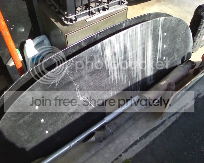

Here's my P1 Spec splitter from RTA @ BW. It took the damage very well!

that didnt look too bad charles... how many laps or time did you put on it?
That splitter was from a 1 day event.
