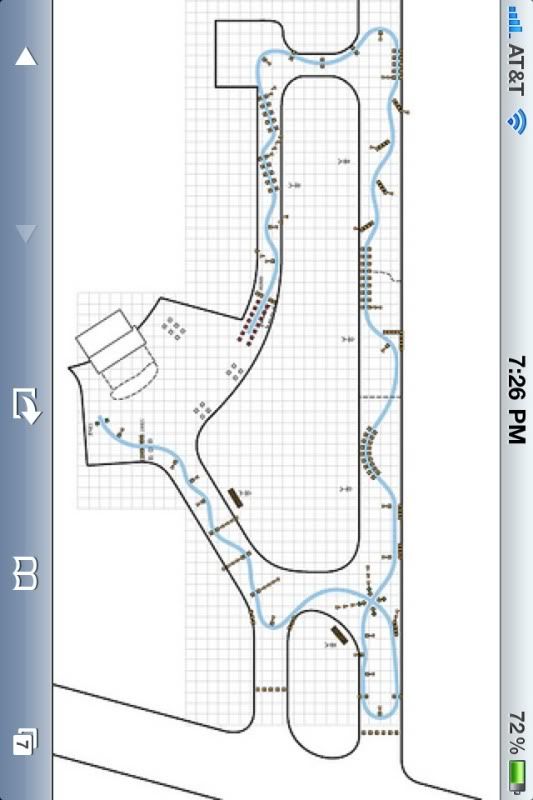

Tire pressures ended up 31 front 26 rears on my final run. The autocross events I participate in most tend to be a bit abnormal and carry a bit more speed which may be why my setup is a little different from the norm.
This is a typical layout, I attend smaller courses as well but tend to focus and enjoy this location the most.
