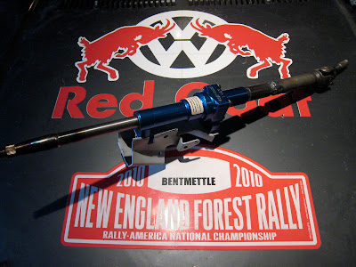

The trick is installing it, have to make sure it's done right to avoid Aryton Senna action.
Or this (ignore the VW logo, was just my buddy who welded the shafts together for me).
This is what I use on my Civic rally car. Coleman 1.5:1 low profile quickener.
