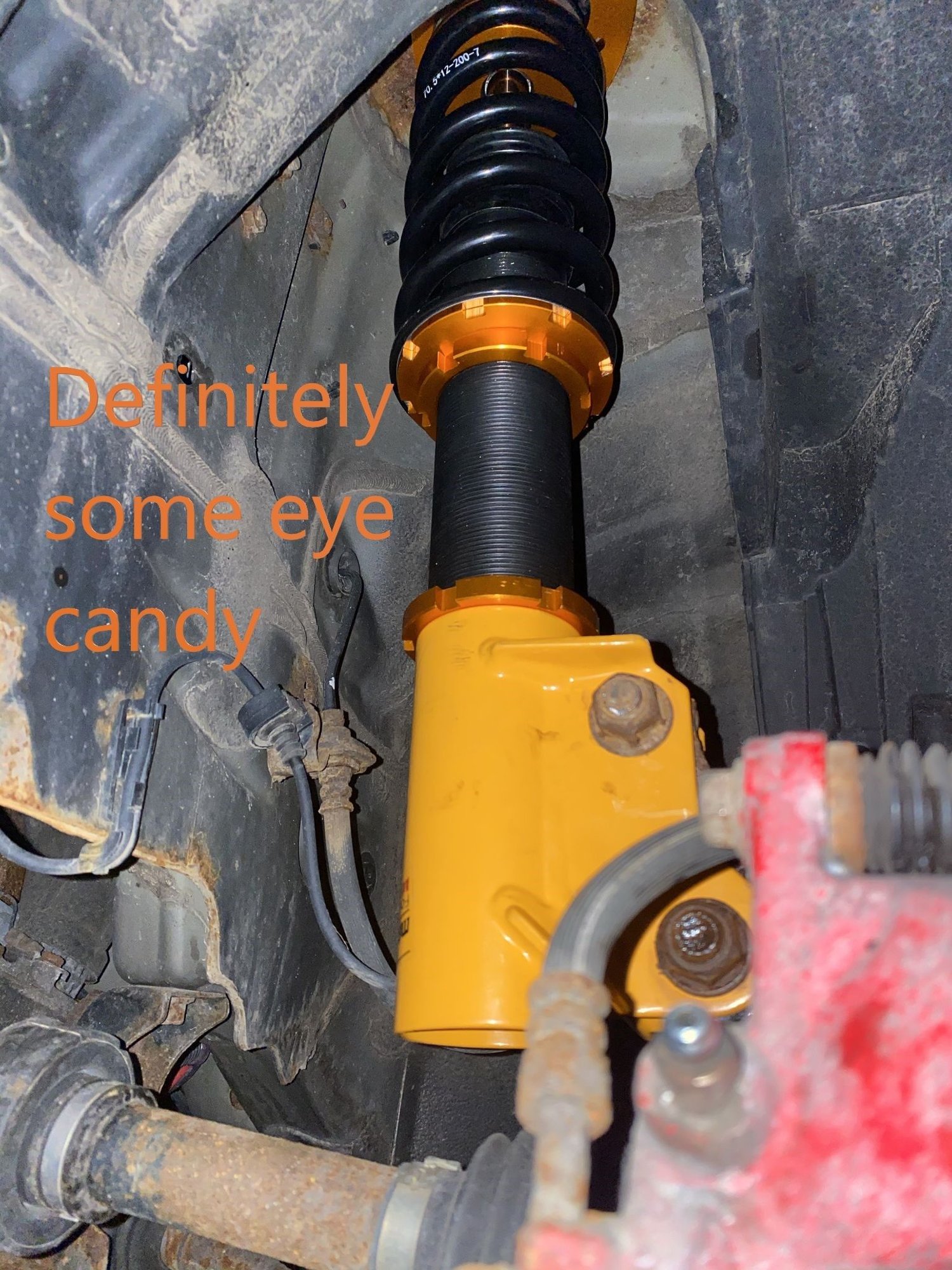

Below are some pictures I took in the middle of the rust war. There are fresh pics of the front during installation, and I went back after a month to check up on the rears.
