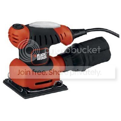

Would using a palm sheeet sander work on a car?

lol,please dont use that.

something like that is better, because it uses a random circular motion , thats what i use to feather out edges and **** when doin body work, nuthin to coarse tho.

i used something like that my 1st time doing body work and its a big mistake...it left crapy marks in the paint i was sanding off and showed thru the primer so i had to take it down and we sand it with 320...save yourself the headache get the other one
