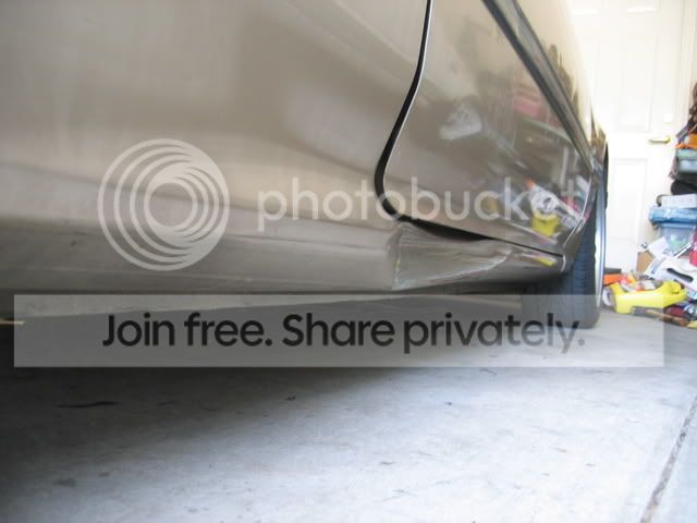

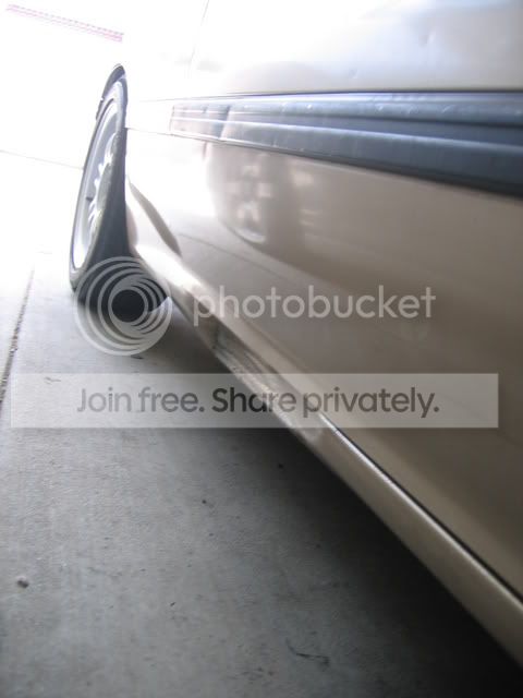

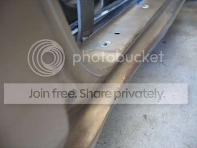

So I received this dent when I accidently hit a low curb. I would like to know how to approach this dent without cutting and welding. I was thinking of using a slide hammer, weld up the tiny holes, bondo and lastly primer. What other methods are there that I'd be able to use. I would assume its say to say I will need a way to shrink the metal if the slide hammer pulls it out too much. Thanks in advance

If you have access to a fram machine, weld a tab to it and pull it.

buy a stud gun and puller, little putty and paint... good as new

Thanks Guys! Any other options, I am not in the budget for a $150 stud gun. I have a cheap 110v Chicago mig welder if thats of any help. Paintless dent removal? LOL

paintless dent remover is not foing to do the job ill tell u that much pull it out and then try your best to even it out good luck

Stud gun is not going to be much good on that dent anyway. You need a frame rack as already stated so you can weld a tab on and make some pulls. Or at least weld a tab on it and use a Morgan Knocker (big *** sllide hammer). I'd replace a section of rocker.

<TABLE WIDTH="90%" CELLSPACING=0 CELLPADDING=0 ALIGN=CENTER><TR><TD>Quote, originally posted by slow_srt &raquo;</TD></TR><TR><TD CLASS="quote">Stud gun is not going to be much good on that dent anyway. You need a frame rack as already stated so you can weld a tab on and make some pulls. Or at least weld a tab on it and use a Morgan Knocker (big *** sllide hammer). I'd replace a section of rocker.</TD></TR></TABLE>id go for the rocker replacement personally myself, more wok, but a better finished product
