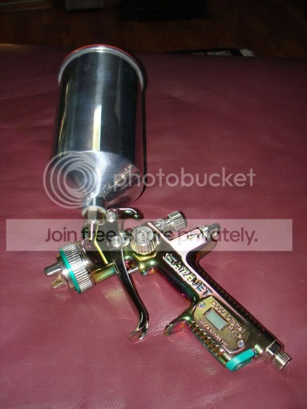

hey if your looking for a nice gun i got a SATa jet 2000 hvlp digital ive used like 3 times..
asking $500 obo

<TABLE WIDTH="90%" CELLSPACING=0 CELLPADDING=0 ALIGN=CENTER><TR><TD>Quote, originally posted by PhantomEG &raquo;</TD></TR><TR><TD CLASS="quote">hey if your looking for a nice gun i got a SATa jet 2000 hvlp digital ive used like 3 times..
asking $500 obo</TD></TR></TABLE>
I've set my budget at under $300. But that thing is niiiiice.
