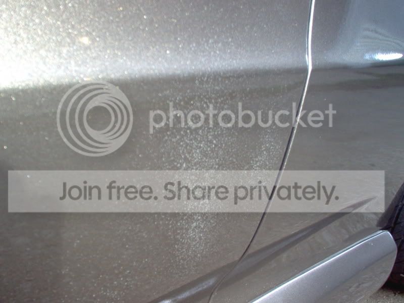

I clayed til I couldn't clay no more! Here's a pic:
When my forearm heals, I'm goin over it again.

WOW that's a lot of over spray.
I would try some rubbing compound. DO NOT get stuff from wally world need to go to a body shop store one that sells auto body paint. They will have what you need. Remember you get what you pay for do not go cheap the cheaper compounds will probably not cut it. If you have never buff before and it sounds like it, you should try to apply both rubbing compound and buffing compound by hand. A buffer "powered by air or electric" in a inexperienced hand will go straight throw the paint so do it by hand will take a little longer but will not hurt the paint job. Need 3 things some terry cloths to apply and rubbing compound and buffing compound.
First rubbing compound apply small amounts at a time apply to cloth NOT TO CAR and do it just like waxing. You should immediate see it to start to come off. Remember try to take the over spray off not the paint job.
Second apply buffing compound just as before they make different compounds for different color cars. Ex. lighter cars like white and silver and so on will use a different compound the one for black. The people behind the counter should know what they are talking about.
Last wax. Should come out like new...

Well, last nite after two rounds by hand w/the rubbing compound & terry clothe, I saw noticable results. Three more rounds (totalling 1 hr) I got most of it (95+%) off. Then came some polishing compound/buffing by hand. As you can see, I typed this the next day since I just regained full use of my hands/arms. BTW, I used turtle wax products as advised by the body shop I went by, which was $8 a pop. Thanx to all the knowledgable folks who responded! We should keep this post up for all those who have the same misfortune happen to their Hondas!
