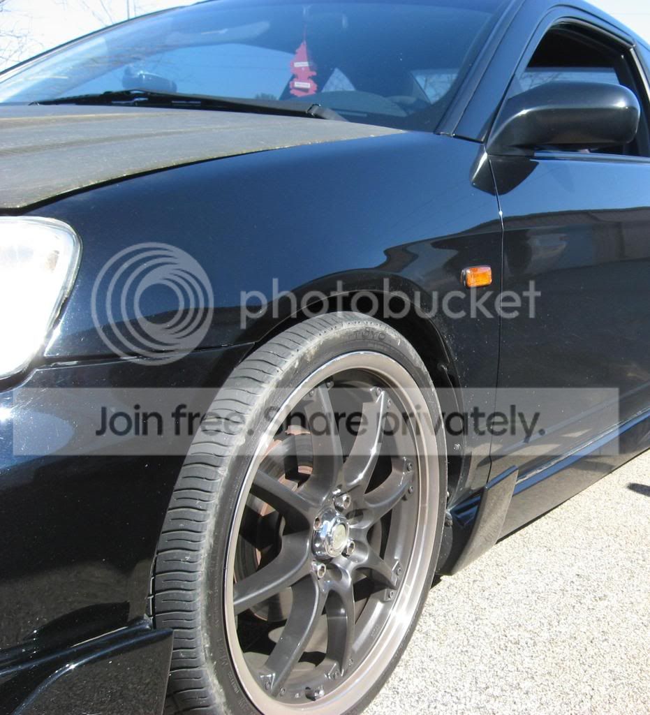

Old Mar 5, 2008 | 06:49 PM
hnycrk's Avatar
Joined: Feb 2008
Posts: 57
From: Atl, GA, USA
Default Re: high build primer? (hnycrk)
Here is a picture, You cant really see the waves but there there. Plus the paint just needs to be "refreshed."
Old Mar 6, 2008 | 02:37 AM
iam7head's Avatar
Joined: Aug 2002
Posts: 17,222
From: SoCal
like powerflow said, don't try to build too much film thickiness from a material that are not meant to be "filling"
the thing you want to use is body filler, on the door/fender you need to bring it to the bare metal and use filler on that(other might disagree but from experience they sticks way better in with bare metal)
on the hood you might not even need high build primer(if it's in good condition), just go over it with a good layer of primer/sealer(esp when the color is that extreme)
