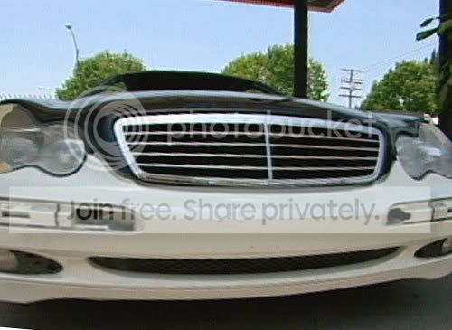

I was watching Trick It Out and saw that they did a front end conversion to this Honda Accord. They made the front into a Mercedes. I just wanted to know how they did that?

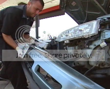

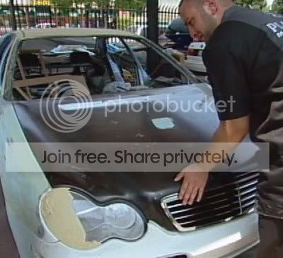

I'd imagine they purchased the front clip of a mercedes and did a lot of custom fabrication to fit everything up. Having worked on a lot of Mercedes at work I can tell you that there really aren't any similarities between the two, so you definitly aren't looking at any kind of bolt up situation. More likely that they welded in the rad support and bumper reinforcement off the benz, and modified either the accord fenders or the edge of the benz hood pretty extensively. You can do anything with enough time and skill, really. Why you would spend the time doing this, I don't really know, though.

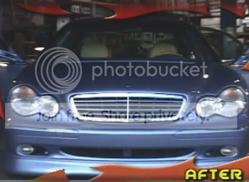

Well this car they actually used the whole front clip. They cut the fenders in half and only kept the mounting parts to the door for the accord and the rest welded the other half of the fender. Hoods usually not that much of a problem, just move the latch to the latch area. They usually use the original supports and just drill new mounting points for the bumper. It's a lot of bondo and fiberglass. Very time consuming because you will want everything to be oem like.
