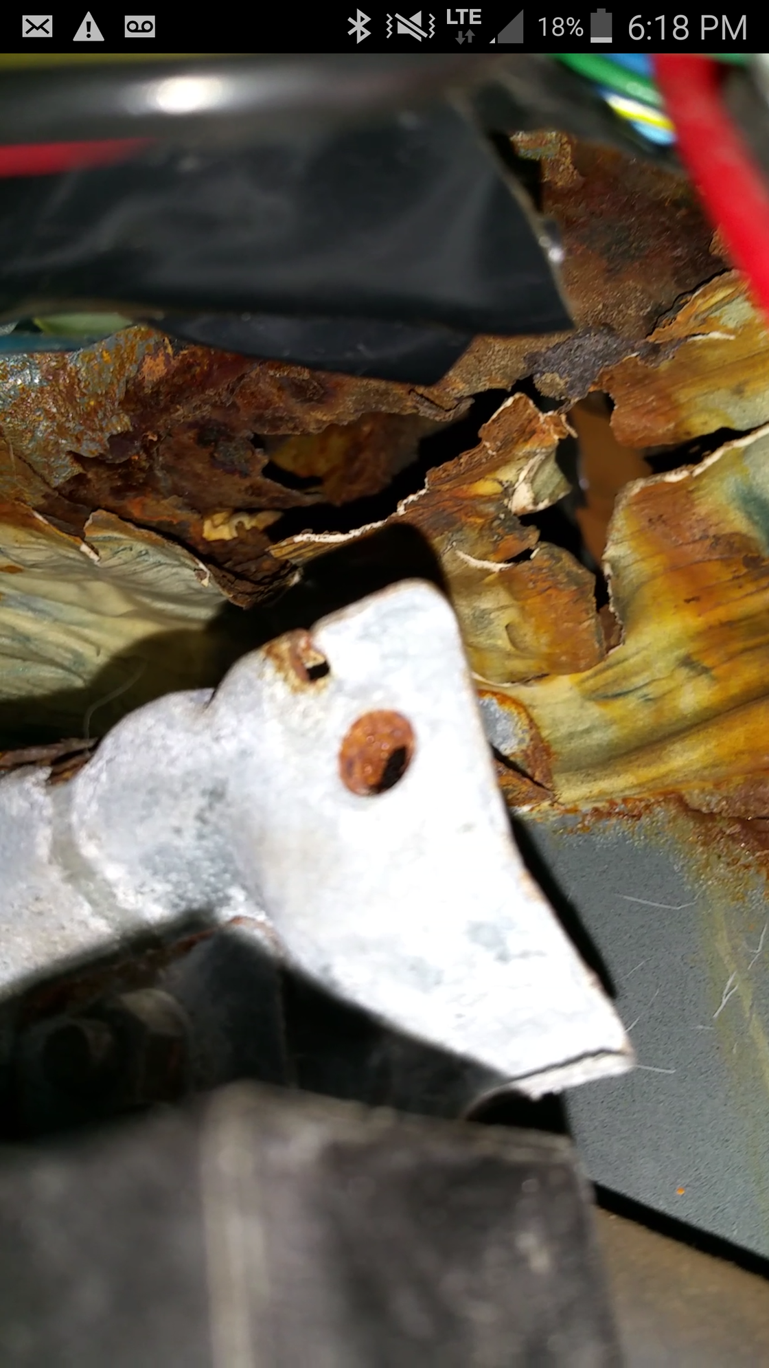

Although i know theres nobody subscribed or following this thread, i have found my water leak and would love someones input on how to repair it. This is the second civic i have seen rot here, water runs down inside the wiper cowl and drains on both sides through the outside "member" the peice i have cut to get behind in the pictures. The water lays inside there and over time...voila. hole at very top corner of the cabin, behind the wiring and relays etc.
From the outside, the outer member cut and the rust behind it.
From the inside. Managed to get phone in there to take a pic.
Looking down on the wiper motor you can see the spot in the bottom right.
And this is the very back corner of this cavity. There is clean metal back there just not sure how to get to it.

You can use aftermarket sound deadening matt sheets on the floors to replace the factory sound deadening matt.
Only way to repair your rust there is to cut any rust out and re weld new sheet metal.
Seems like a lot of work though.
To get the rust out of the floor brace will be tough, if you manage to get it, use this to seal it!

I have managed to find the hole from the inside. Its up on the left hand side behind a bunch of wiring and relays and such. So now im debating, i have never had the dash out of one of these cars, I know its not too difficult to take out but i have no idea if that will give me access to this hole or is there still going to be the dash frame and wiring and such in the way?? Any input greatly appreciated!
