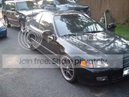

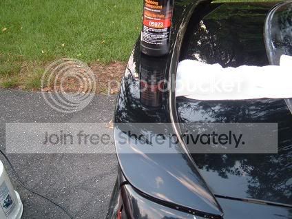

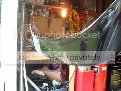

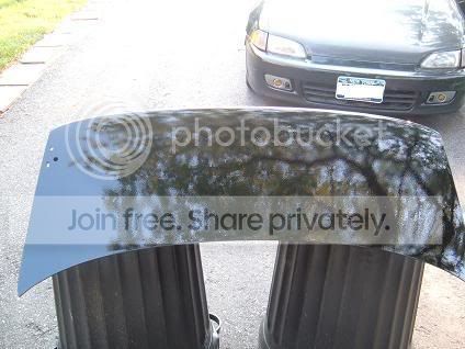

Let me start off by saying i have no experience at all with painting..i used a single stage paint and sprayed out of a 1.0 tip,hvlp fun with a crap *** reg at 35psi..just need some advice on how to reduce the amount of orange peel..
the victim:
the trunk:
spolier:
