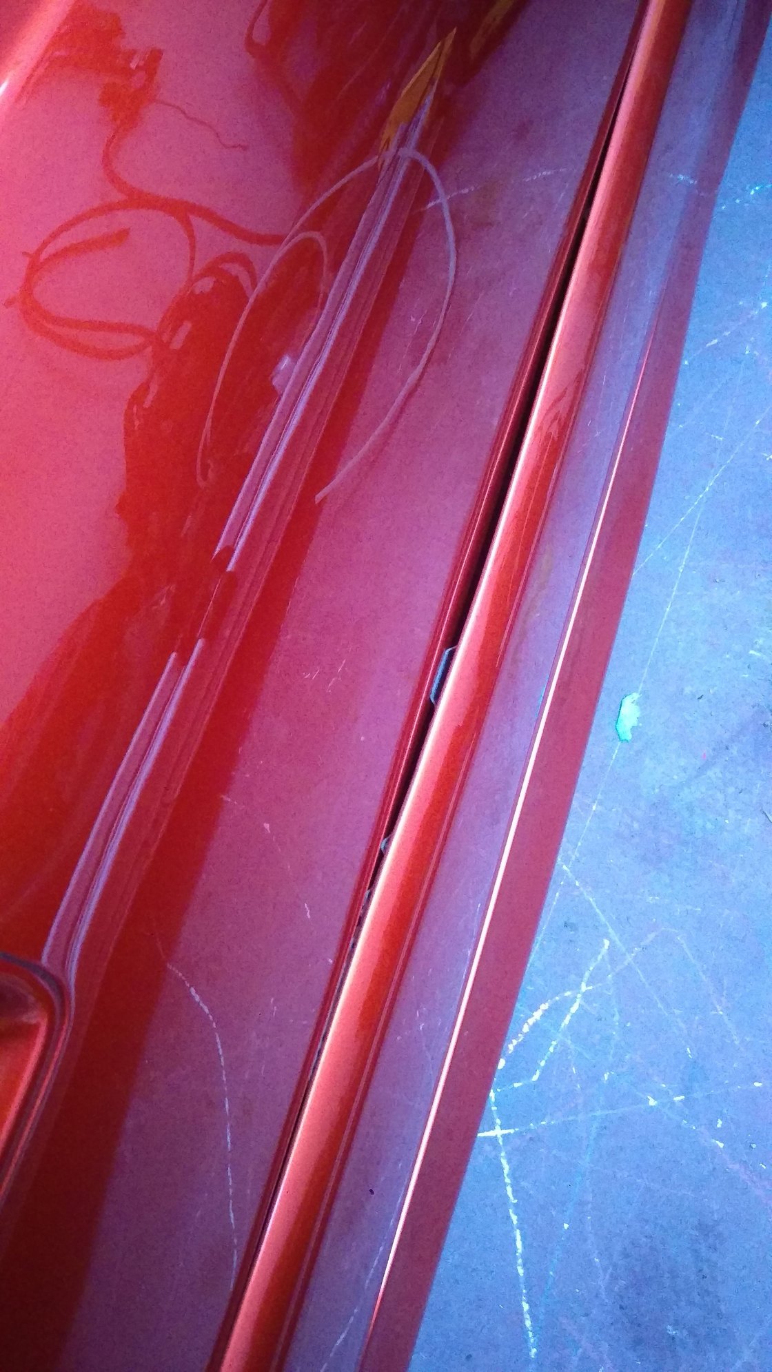

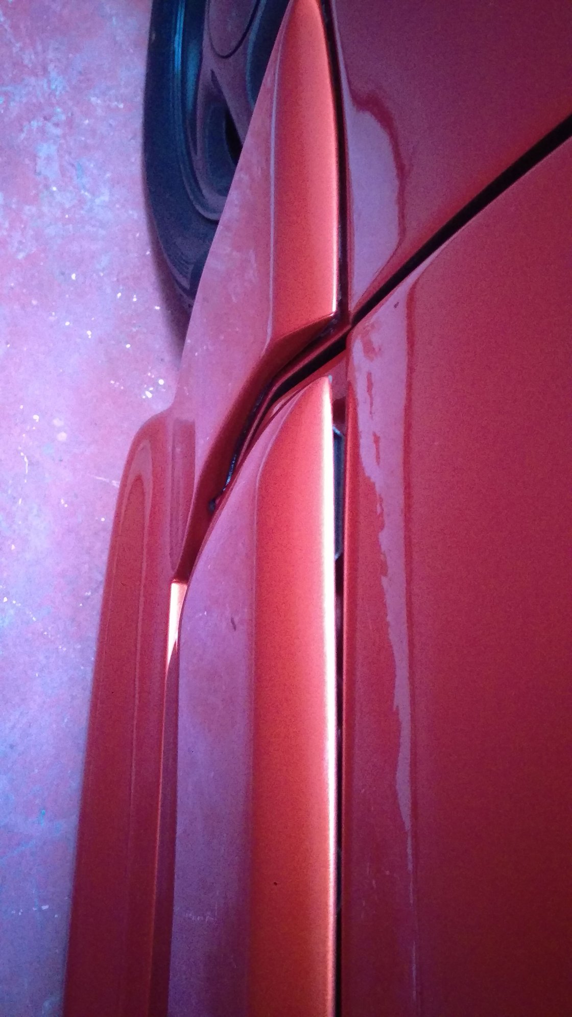

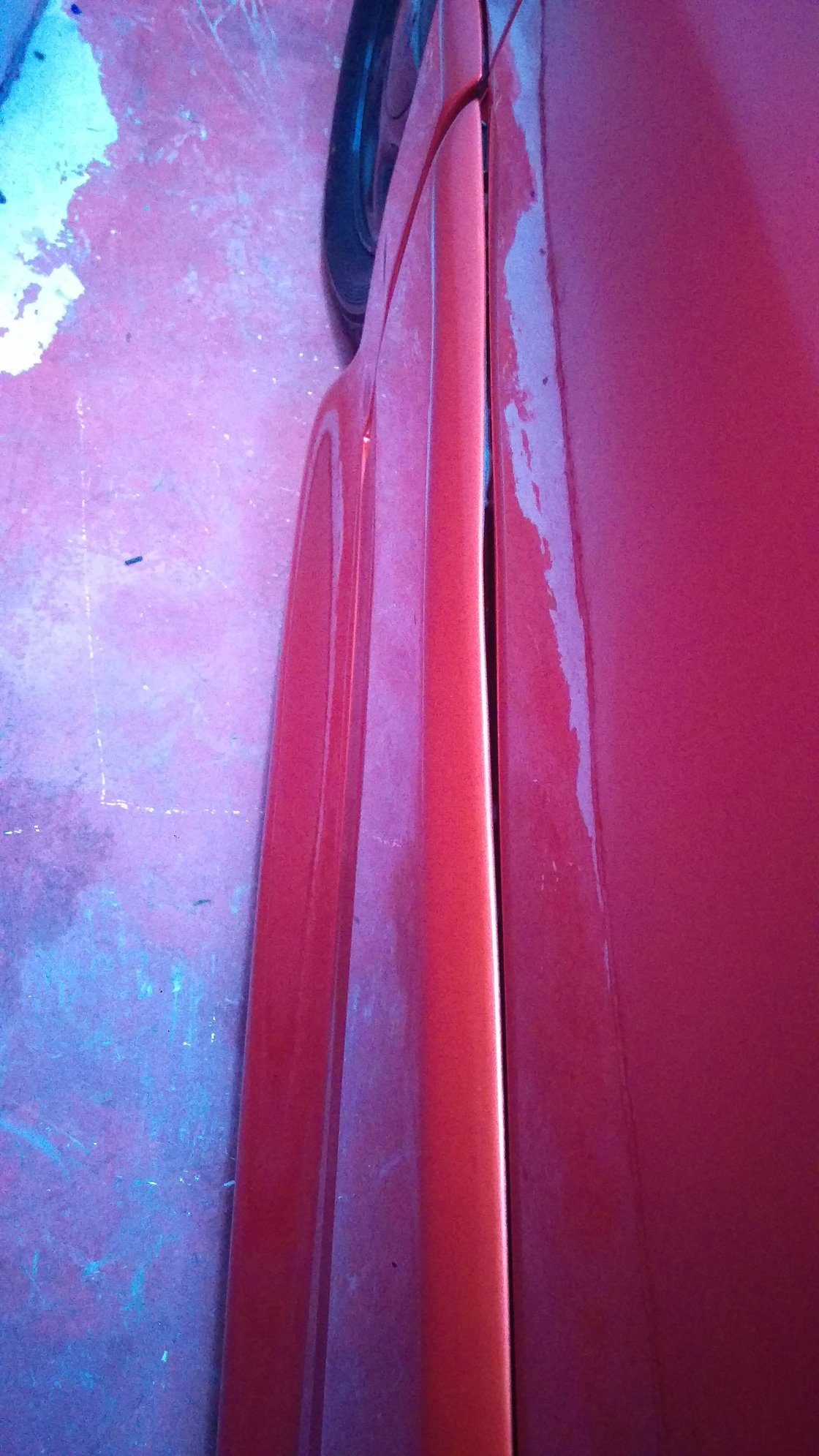

Lh mid
Lh front
Rh mid
Crx door cap

Looks like the molding is warped a bit.
Use a heat gun to soften it up and then stick it on.
