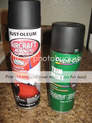

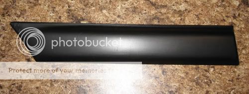

I've had that exact same problem, and heres what you should do for cheap and fantastic results.
Get these :
Spray the stripper on, wait for the paint to bubble and peel it off. Ive left it on overnight before and IT DID NOT DAMAGE THE PLASTIC. I used only the spray on kind, not the thick kind in the can, cus im sure its a higher concentration and would damage the plastic.
After all the paint was off, I washed it real good and sprayed the trim paint. It looks awfully sexy. all for around 15$ and some work.
