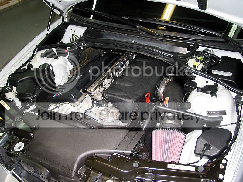

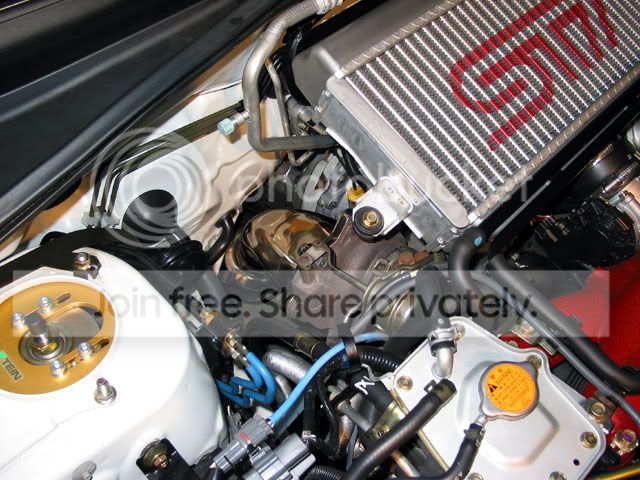

the process i use works great..
Foamy Engine Brite.. you can get that stuff at any autozone, carquest, kragen, checkers, whatever.. spray that stuff all over the whole engine bay.. let it soak for about 10 mins.. rinse, or pressure wash it off.. then what i do next is take a leaf blower or compressed air, and blow the water off.. follow it up with some CD2 engine detailer.. let that stuff set til its nearly dry, then use a damp cloth to wipe everything down so the CD2 doesnt puddle up.. CD2 will dry to a resin so it doesnt have that unprofessional greasy look and all that dirt buildup later on...
here is my engine with 60K on it..
my STi engine .. i did this process like once every couple months..

That looks amazing. Can't argue with those results
