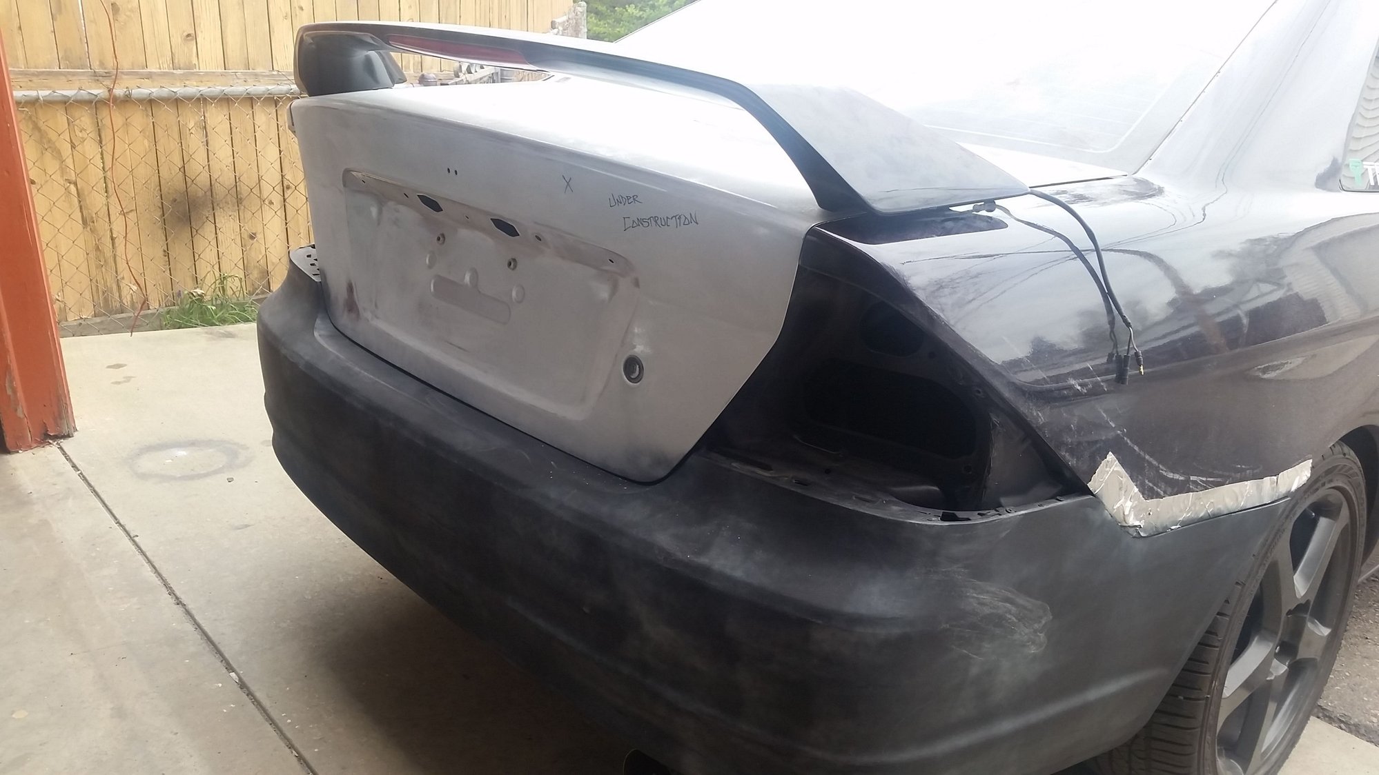

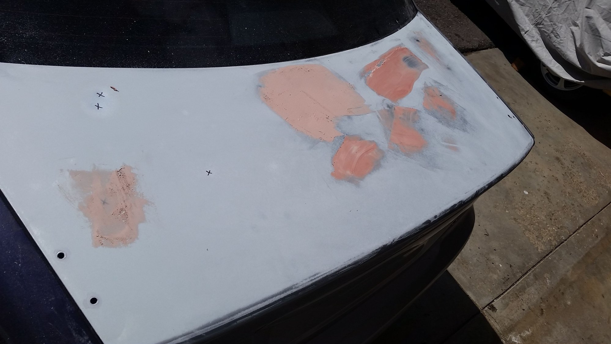

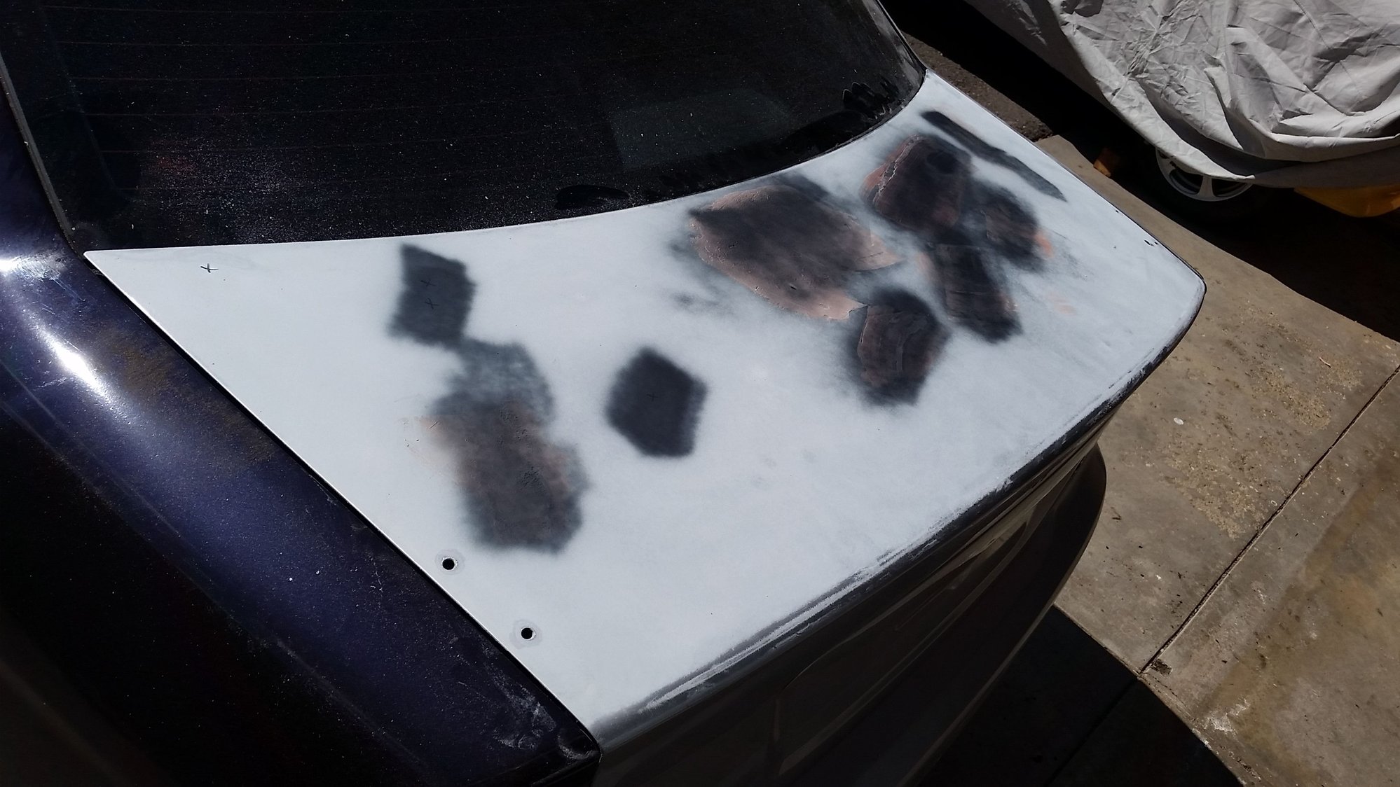

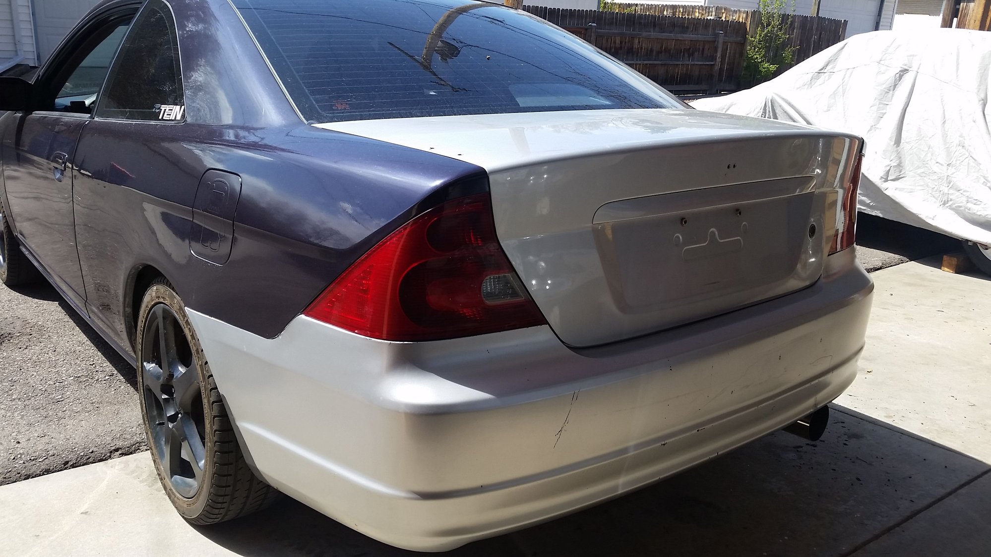

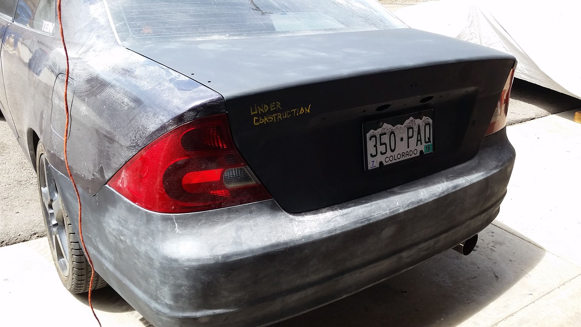

Hello guys I'm new to the site and I tried searching for a diy paint thread sorry in advance for starting a new one. I'm seeking some advice on car paint. It's my first time attempting to paint my car on my own. I bought an HVLP spray gun from harbor freight and am borrowing a 60 gallon compressor. I have done all the body work and repaired the dents on the trunk from hail damage. Im not the best at body work but I also don't wanna pay for a professional paint job since I just plan on using it as a daily driver. I plan on painting it all black again. What primer, paint reducer and paint brand do you guys recommend? I was looking for something decent nothing too expensive. Tips and advice would be greatly appreciated.
