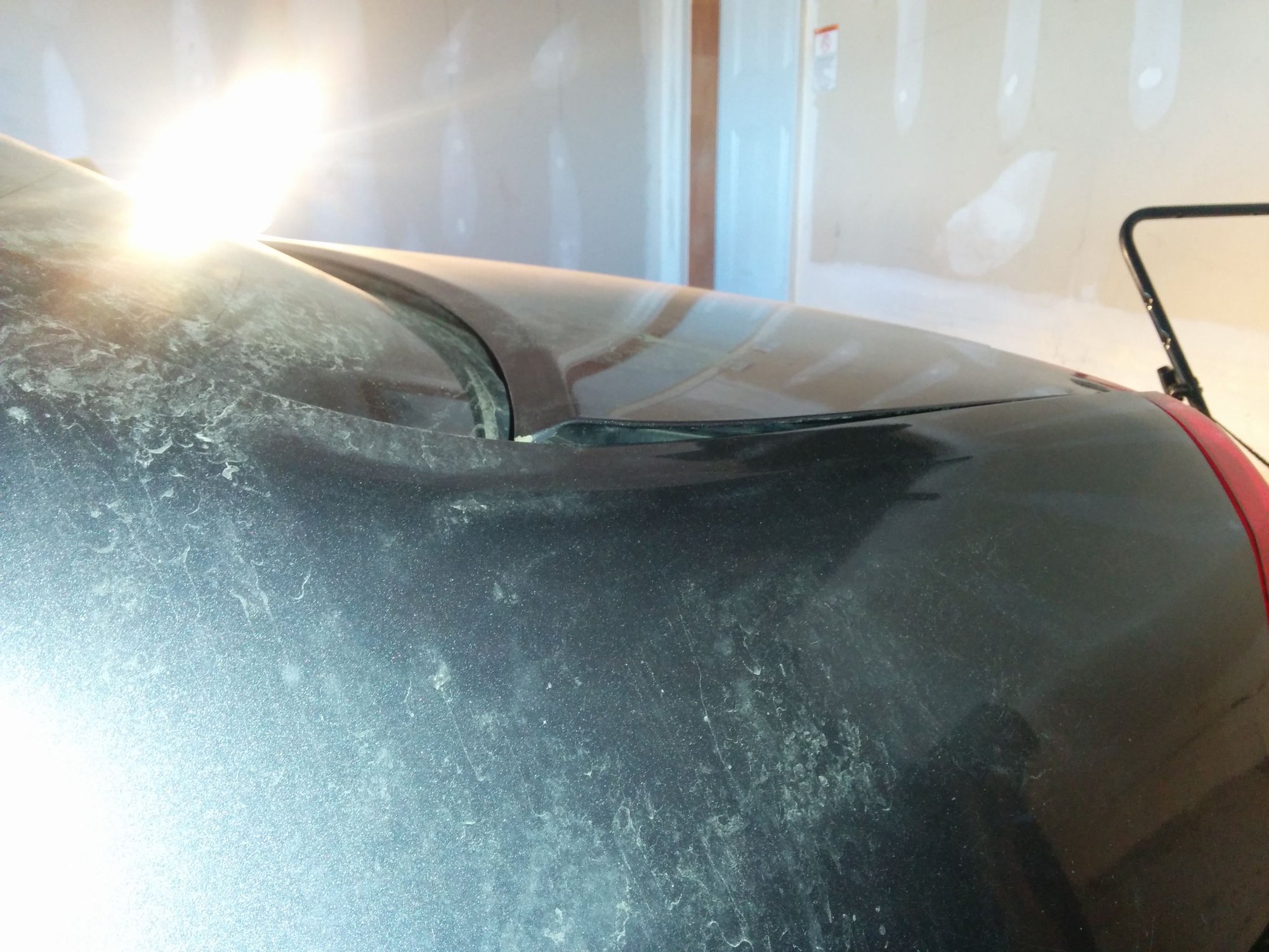

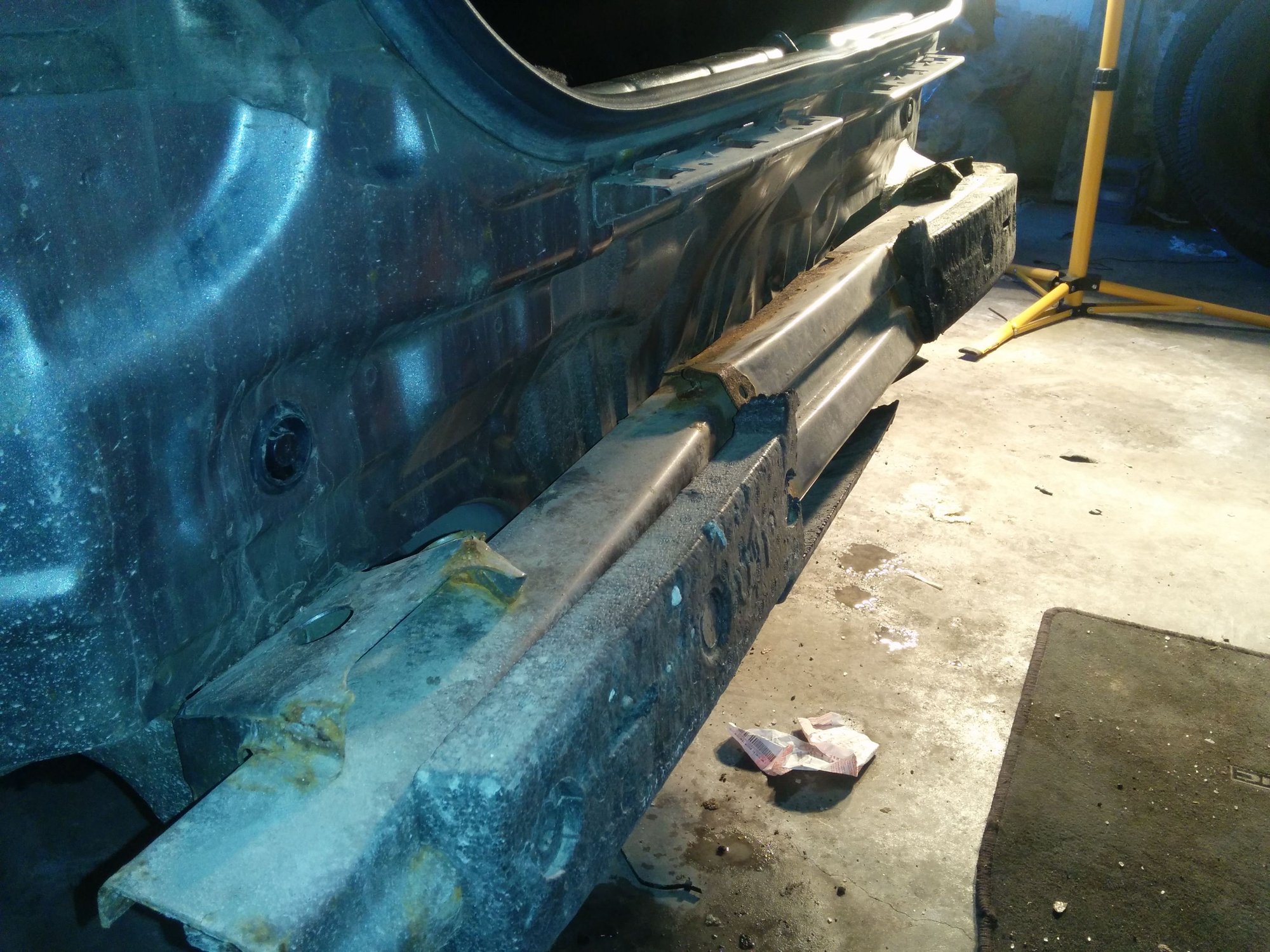

Hello Guys, I am new to this forum.... i have been browsing for past few years, and finally decided to make a profile because I realy need your help. I am from Toronto, Canada and recently i bought this car from an auction and noticed that is frame damage in the rear end. Can't seem to figure out if it is actually bent. the trunk closes but i have to push it down with more force. And there is misalignment on top of the trunk.
I have not taken into a shop yet... will need to be towed.
Pictures at attached

That happened to me once. I had to replace the lid and crash bar. I got lucky and I simply was able to bolt parts back up and get a good panel alignment. Seems as if the trunk latch was pushed
Most likely will need replaced..

If you want to know if the frame is bent you need to measure in a big "x" shape at matching points. Looks more like the crash bar and truck lid need to be replaced, first then go from there.
